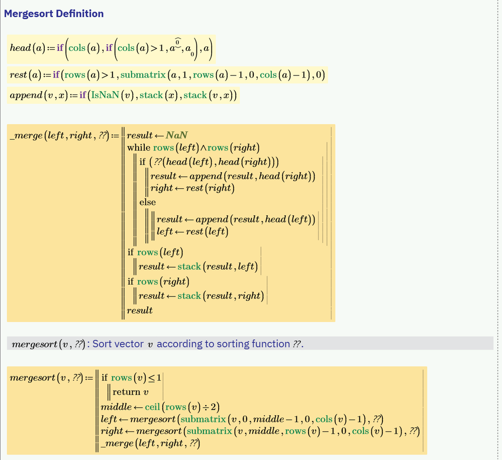

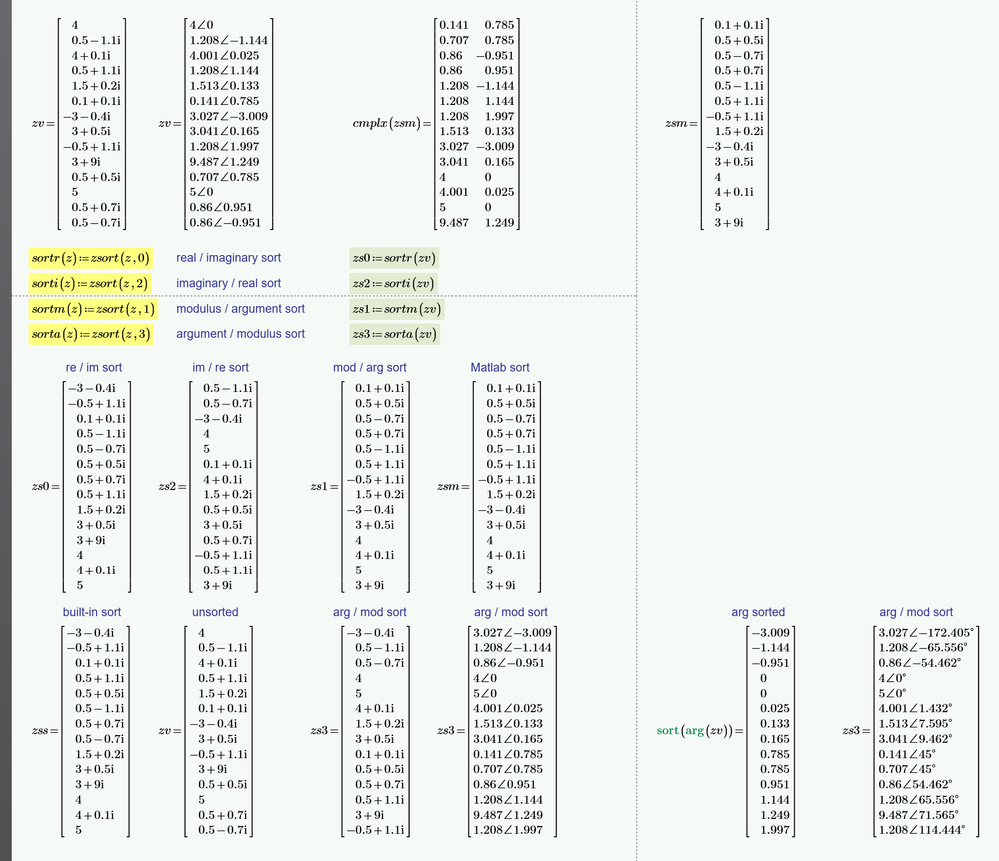

Following on from the discussion re minima and maxima of various Mathcad data types, I gave up on trying to fault-find my original (messy) complex sort worksheet, and present the following simplified Mathcad Prime 11 version for your edification.  It's based on merge sort.
zv is the complex-valued vector to sort, and I've rerun the results in MATLAB.

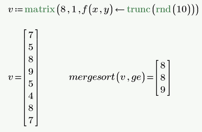

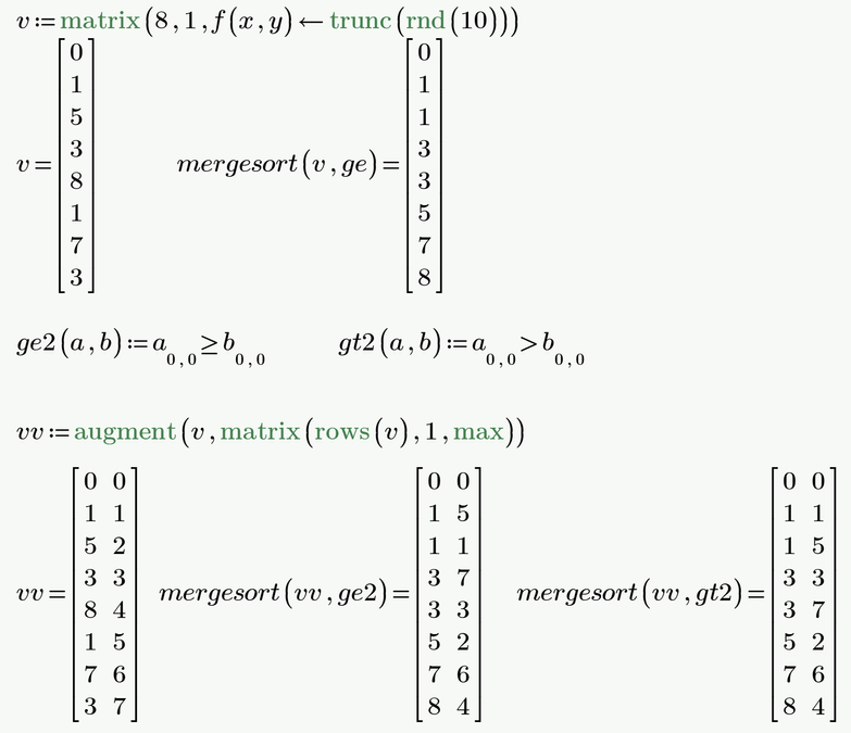

What am I missing?
(To:Werner_E)
A quick hack to fix the problem with 1-column matrices:
StuartBruff
23-Emerald V
(To:Werner_E)
Yes, effectively the same solution.   Great minds ... 😈

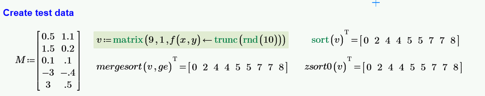

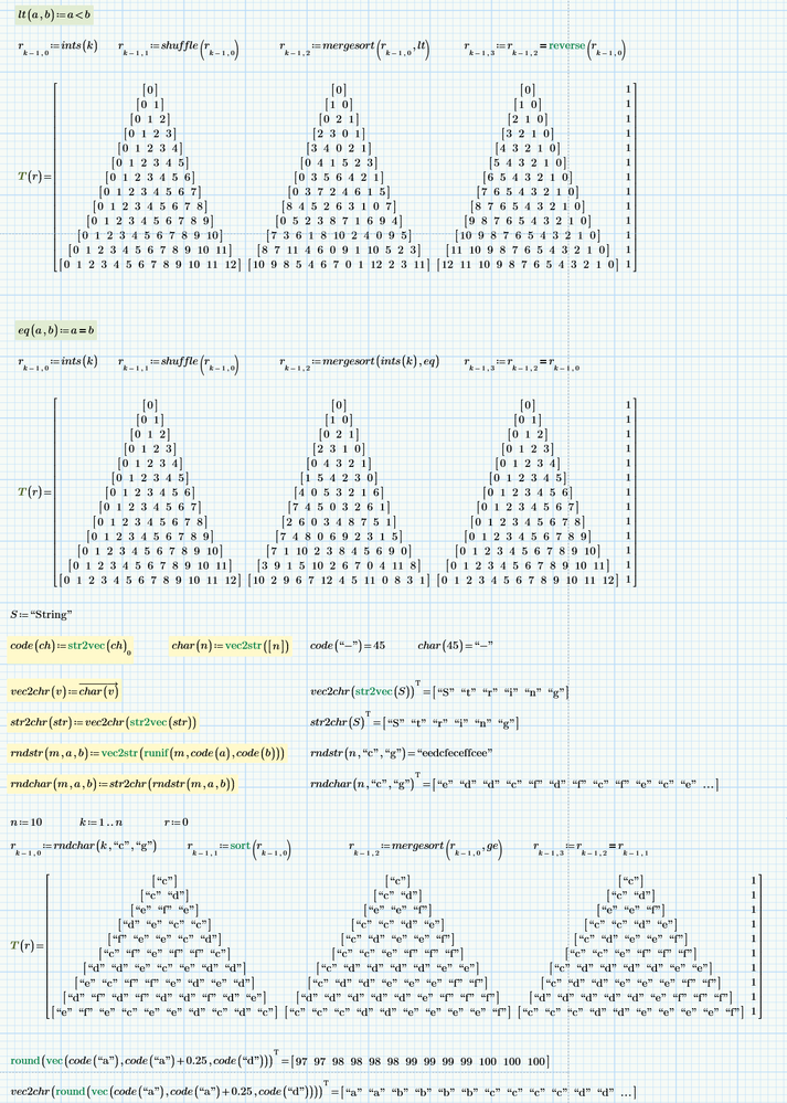

Then I realised that, in terms of testing, I'm busy doing all the barking when I've got a perfectly good laptop that can do that for me:
Stuart
StuartBruff
23-Emerald V
(To:Werner_E)

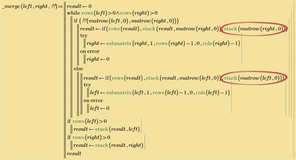

Hmm.  Yes, avoidable if we had the empty array, but never mind.  I snagged a couple of functions from my Express library.
Hopefully, the problem is now fixed, the code appears more elegant, and is ripe for conversion to Express.

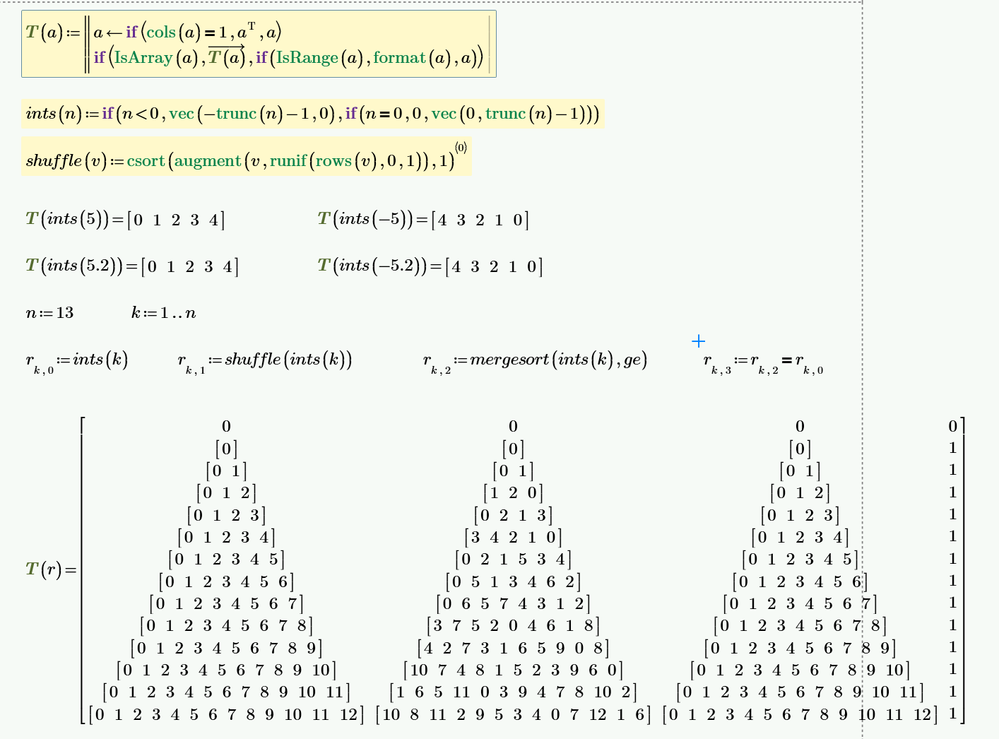

Hopefully, I will test my worksheets more rigorously in future.  ( 🤣 )
