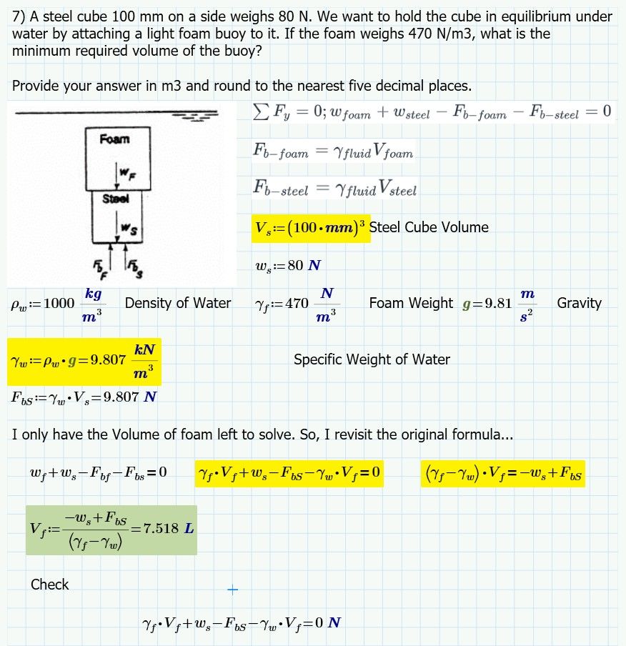

I'm using MathCAD 9.0.0.0. I get this error on my last equation...
Solved sheet enclosed.
Cheers

Again you try to add quantities of different dimensions!
wf is force density but ws is force.
