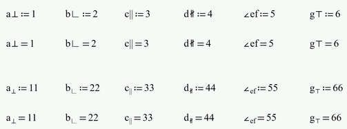

I was curious and created in Mathcad 15 a sheet with the perpendicular sign as subscript (its quite easy to do there) and converted that sheet to Prime5.
Alas! We now have the subscript working in Prime, too. Still no clue how to create it in Prime alone but I guess there has to be a way to do so.
Prime5 file attached, so you can at least use copy and paste to create your own variable names.

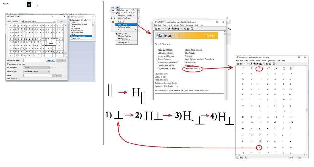

(To:elund)
try like this:

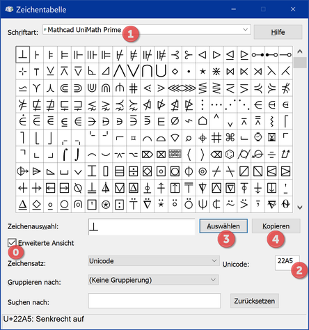

1) Go to Start/windows icon at the lower left and start typing "character map" without the quotes and start the program - it will show up in your localized version (in my German windows its called "Zeichentabelle").
2) Go through steps "0" to "4" in the following screenshot to copy the character (or any other) to the windows clipboard.
3) Now you could easily insert that character into  a textregion, but it will refuse to be inserted as part of a variable- or function-name. So now comes the trick part. Lets suppose you want to create a variable name x followed by the perpedicular sign.
3a) Type double quotes - you will get automatically a pair of them
3b) Inbetween those quotes type x and then Ctrl-V to insert the perpendicular sign from the clipboard
3c) Type Del (delete key) to delete the quotes - you just have created a Mathcad variable name with that special character which you may use as any other variable name.

(To:Werner_E)
