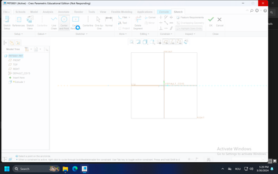

Hi. I instal creo 3.0 on VMware Fusion but it run very slowly and I can't even make a circle  . Any solution on how to make the virtual machine faster (it runs windows 11)?

slow response can be caused by graphic drivers.
Try adding following option at the end of config.pro file using Notepad.
graphics  win32_gdi
