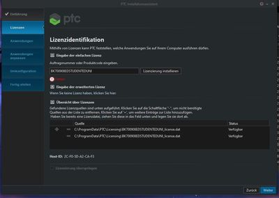

Hello
I just tried du refresh the student licens for Creo 7.0. I get an error in the PTC installationsassistens, when i try to refresh the licens.
Thats the licens i got from my professor:
BK700908EDSTUDENTEDUNI
Thank you for your help!

remove all files from C:\ProgramData\PTC\Licensing directory and try again.
Martin Hanák

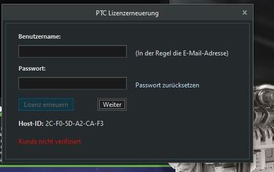

I tried it and it still doesn´t work...
Is it possible to get an other licence file?
It would help me a lot 🙂
the installation was successfully with your hint, thank you a lot 🙂
I used the code: BE700908EDSTUDENTEDK12 instead ok the code my professor gave me (BK700908EDSTUDENTEDUNI) and now it worked.
Is this a problem for my account in the future?
