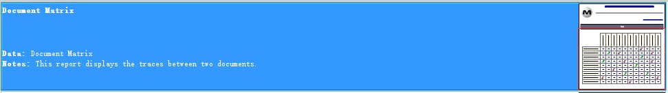

     Integrity report template of Document Matrix displays the traces between two documents,but i have many questions about it as followings:
     1. what's the trace field for use to traces?
     2. can i customize the trace field for my own report view show it likes as follwoing pictures?
does anybody knows the answers, if anybody konws or have good idea to solve this questions, please give me a response.

    Hello Jason,
    in fact, the relationships are hardcoded within the report template itself.
    Look for
    <%beginrelationshipsdetailL2 Decomposes To, Satisfied By, Validated By, Modelled By, Verified By%>
    Therefore, you need to change this line according to your needs.
    Hope this helps
