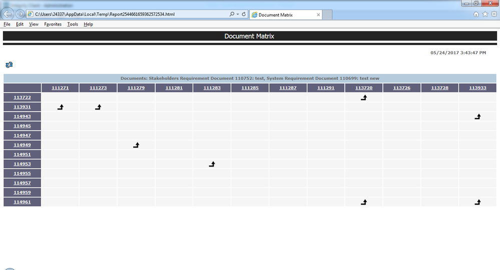

Hi Balaji,
You can create Traceability Matrix for the same requirement you have...
Please check my screenshot and let me know do you want this ??tracebility.png
I think this is exact you want ???
Waiting for your quick response  ??

Hi Kapil,
Could you please let me know the procedure to generate such a traceability matrix shown below.

kjain-2
(To:jhm)
Hi @jhm,
That matrix report is OOTB provided by PTC but may i know about your exact requirement like in between which document type you want this kind of report etc. ?  Because after looking to your exact requirement we can think of creating our own report with recipes created by me that includes more features as compare to OOTB Reports.
