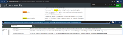

I couldn't find any documentation regarding how to use custom dialog when developing custom widgets from any of these documentations. Are there any documentation for custom dialogs?
taken from thingworx_extension_development_user_guide.pdf

I think this topic is leading the wrong way. Maybe I'll rephrase my question. What I meant was how to create this dialog when developing or creating a Custom Widget. This is the example dialog from Mashup. Another widget that has this dialog is the Grid Widget. By using this dialog, we can make the widget configuration to the next level.

The reason you have not found any documentation on the 'custom editor' is that it's an internal API only and is currently not intended for external use. The custom editor is used for certain PTC widgets that deviate from the standard configuration options. This would be a feature request for Mashup Builder and Widget development. I will inform PTC Product Management about your request.

thanks for the information, but when it's an "Internal API" why is it mentioned in the Documenation?
customEditor | Name of the custom editor dialog that should be used to set and edit the widget configuration. In your widget project create a dialog box with the name TW.IDE.Dialogs.<name>. |
customEditorMenuText | The text that appears on the flyout menu of the widget. It is also the text that appears as the tooltip for widgets in the ThingWorx Composer . For example, Configure Grid Columns. |
Thingworx and it's documentation are making promises and raises expectations that cannot be kept.
