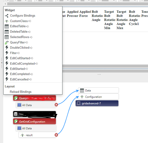

Feb 13, 2020 8:23 PM UTC
Hi @Velkumar.
From our testing, we're not seeing an issue.  If you select the grid, in the upper-left corner is a drop-down.  From there you should select Configure Grid Columns.  You then have the ability to align the header or the data.
Please let us know if you're still having issues.
Regards.
--Sharon
Velkumar19-TanzaniteAuthor
Feb 14, 2020 4:26 AM UTC

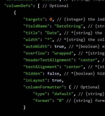

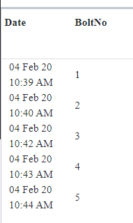

Hi @slangley
Thanks for your response. I have mapped configuration dynamically, so I'm not able to find 'ConfigureGridColumns ' in widget.
In configuration, I have mentioned 'textAlignment' as center
Still header and text are not aligned
