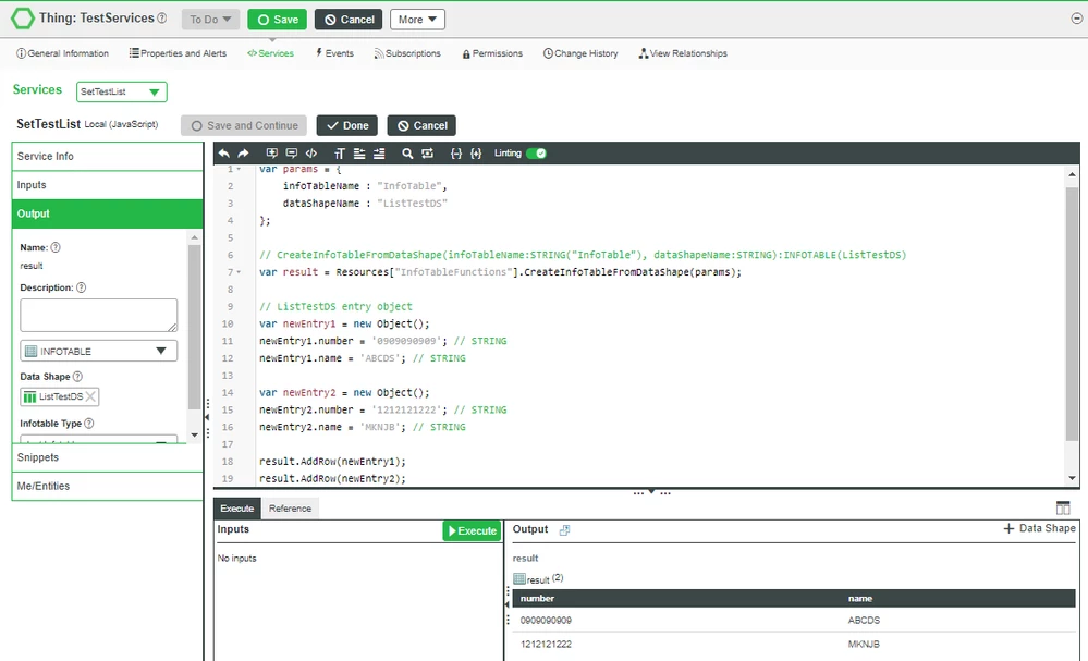

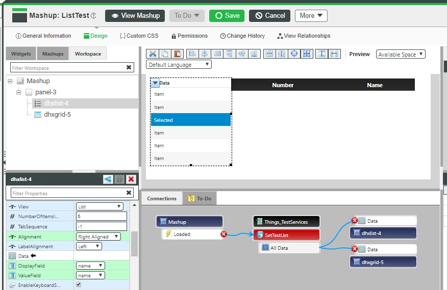

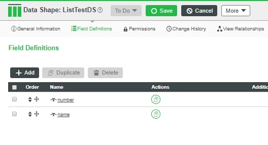

I have come across a problem where the list is not showing the data. I have used a single service as a data source for both list and grid widget but only the grid is showing the data.

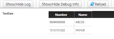

Output: only grid is showing the data

Everything you did looks fine and it gives me the expected result:
I know it sounds very obvious, but have you tried to remove the list and add it again?
muhammadt31-VisitorAuthorAnswer
May 13, 2019
The problem has been fixed now!
The problem occurred when I changed the style definitions related to Grid Widget. I again changed the grid style definitions and the lists showed up again.
