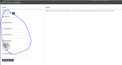

I am facing problem in logging properties there are some values which are repeating after I carry out the experience multiple times.
PFA attached image in which arrows are shown on the readings which are repeating when I consume the AR experience on my Ipad on view app for multiple times.
I just want to log the properties which are entered by the user on vuforia view app.

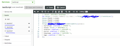

My purpose is I want to enter records row by row into an infotable.
eg, I have these field definitions in datashape: ID, Name, Status, TimeStamp - I want to enter records for these columns,
Record1: 1, Name1, Pass, 27/03/2024
Record2: 2, Name2, Fail, 27/03/2024
Record3: 3, Name3, Pass, 27/03/2024
Thanks in Advance.
