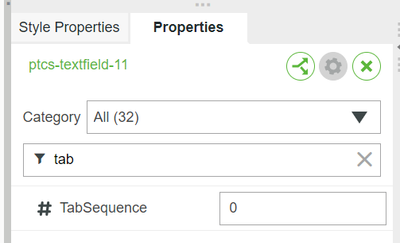

I have mashups specific for mobile screens. Whenever open those mashups if it has a textfield it is automatically opening the keypad. How to check which triggers this. Is there a way to fix it. The focus should happen only on touching the field

Hi @KT_10107318
Try updating TabSequence as -1 for text field widget
/VR
Velkumar19-TanzaniteAnswer
May 27, 2024
Hi @KT_10107318
/VR
