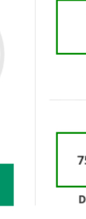

just i am looking for dividing the widgets using divider widget, but it will be vertical line.
just see below img...wirh vertical line.

Hi @VaibhavShinde
You can insert new container between two widget and change the color of container. (PFB PNG for reference)

velkumar,
i cant use this, because i already used Divider widget for Horizontal line which is a very thin line, now just i want it vertically.
why we dont have divider widget for vertical line.?

Hi @VaibhavShinde.
Per Velkumar's post, you can add a container.  The container will need to be set to a Fixed size of 1 (or more pixels) as needed.  You can set the color to match that of the horizontal line.
