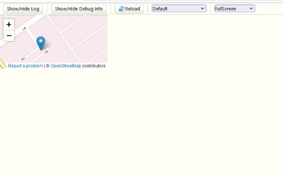

I am trying to use openstreet map as it is free unlike the google maps widget, but i dont know how , so i though to use the Html Text area widget  as i couldnt find another html widget, i put this html inside it :

 <iframe src="https://www.openstreetmap.org/export/embed.html?bbox=49.981493,26.245890,49.985093,26.247870&layer=mapnik&marker=26.246400,49.982544&noheader=true&nofollow=true&nozoom=true"

when i run this html in a separate html file the map take the whole window and this is what i want , but when i put this same code inside the text property in the html txt area it only take a small area in the corner like this photo,
i am using thingworx 9.6 , i also couldnt use leaflet , when i installed it from github i cant finde the map link option and it felt like it is not going to work proprly , so how to do what i am aiming for, which is show some coordinates on a map and also make something like a tracking line to show all the previous locations also,

PEHOWEAnswer
Jan 10, 2025 8:31 PM UTC
Hello @IA_10816220 , Figured out the issue of expanding to fit container.so Here is an update. Have fun
