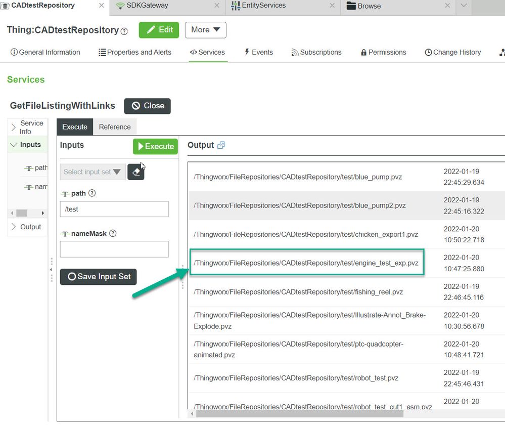

Yes, I think there is issue that in the LoadBinary-complete event the file data is not complete on the mobile device. But  I think there is  another very easy way to do this.
Example of the return values of the GetFileListngWithLinks:2022-03-08_12-46-13.jpg
In this case on the mobile device ( I verified that this is working on IOS and Android) will load the file then. But requirment is that the Repository Thing with service GetFile ListingWithLink is registered  in the Exeternal DAta section
Then this code will work fine

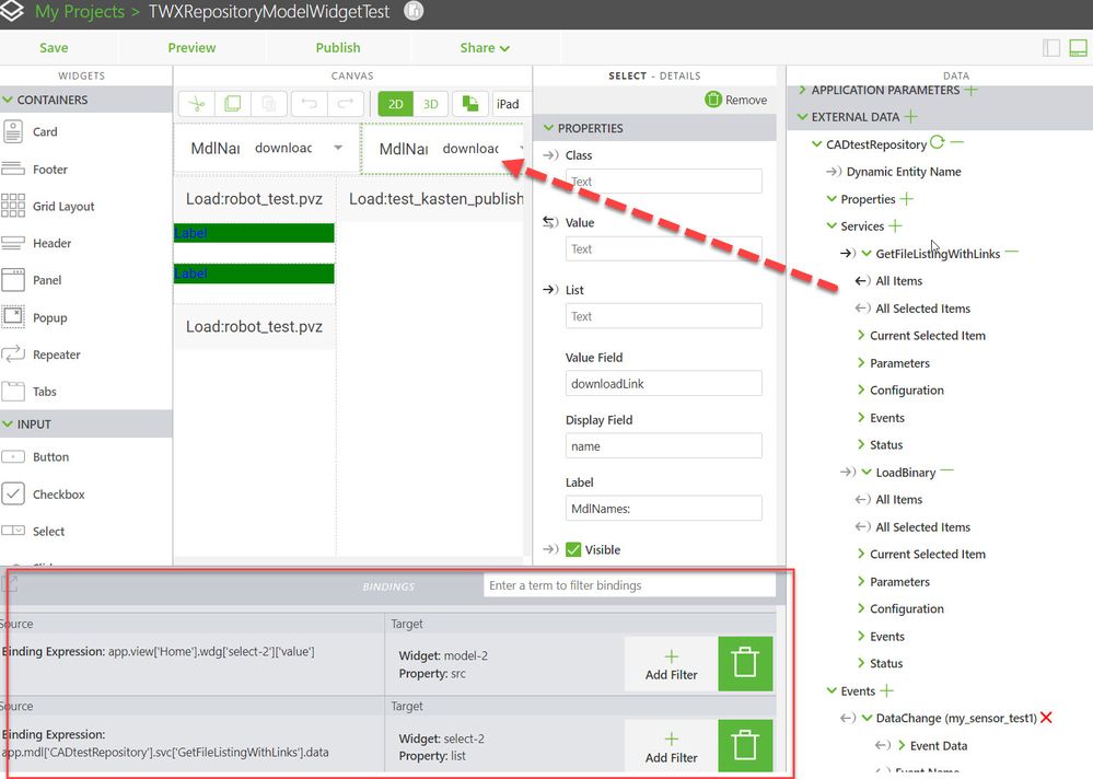

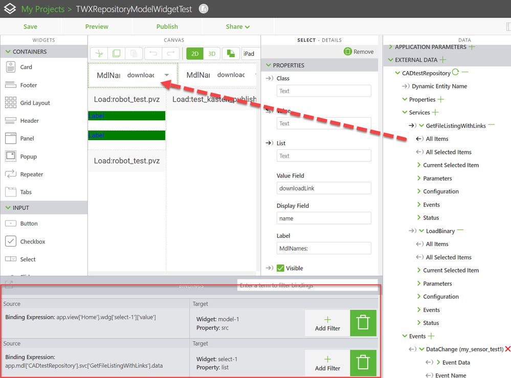

here I want to add a demo project . But this project  is connected with a TWX /ES instance what I need to start and to pay attention that it is active.
To change it to you own database you need :
- first set the epxerinece service link in the Studio Configuration > info Tab
- in the Home.js change this
$scope.LoadFileFromTwxRepository = function(path) {
 console.log("calling LoadFileFromTwxRepository")
 var TWXmodelID = 'CADtestRepository' // you repository Thing here
 var serviceName = 'LoadBinary'
 var parameters = {"path":path}
 twx.app.fn.triggerDataService(TWXmodelID,serviceName, parameters);
 $scope.$applyAsync();
 console.log("after call of LoadFileFromTwxRepository")
and  in the 2 button click events change the value of you path
//Button-2
LoadFileFromTwxRepository('/test/robot_test.pvz');
//button-1
LoadFileFromTwxRepository('/test/test_kasten_new1.pvz');
- in the External Data Secition add the service for the File repostirory according to the picture 1 for select-1 widget:2022-03-08_10-28-13.jpg
and  picture-2 for the select-2 widget:
