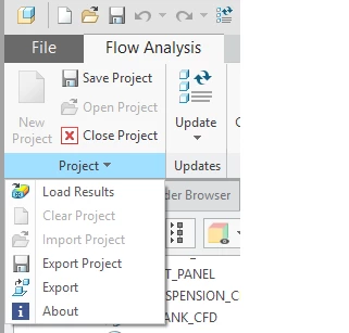

In the latest versions of Creo 5.0 (5.0.1.0) and Creo 4.0 (M050) there is the option to Export the streamlines from the results:
This allows you to export an OBJ or a PVZ of the streamlines.  From what the PTC guys told me the rest of it is then done in Studio using some custom shaders, but I don't have the details on them unfortunately.

August 1, 2018
Great thank you, not sure how I missed that.
Only problem I am having now is the streamlines are losing their colour.
My pvz files dont display in Studio while the OBJ files do.
August 9, 2018
Currently it is not possible to import or export the color data with .obj file in Creo Parametric.
