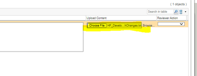

Thanks for the reply Vivek. I agree with your points. Below  is the detailed requirement.
I have a custom wizard in which I have implemented a custom MVC table with columns like below
Here, in this table, I want to include new column which is uploadContent so that for each record user should browse and attach a document

AKC
(To:HelesicPetr)
Hello Petr,
I could able to get the browse option by using ContentDataUtility. Your input helped me a lot. Thank you!!

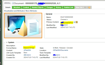

AKC
(To:HelesicPetr)
Hi @HelesicPetr ,
This is extension to above requirement. I could able to attach documents in custom wizard table column.
I can also able to fetch file name which I attached in form processor. However, I have below challenges.
1. I am not able to get the location of the file which I attached in form processor.
2. I can only able to fetch file name, but location ,  HolderLink are coming as  null in forocessor
(Below is the code I wrote to fetch the attached file in formProcessor sing nmCommandBean)
Map<String, String> text = bean.getText();
for (Map.Entry<String, String> entry : text.entrySet()) {
String key = entry.getKey();
filename = entry.getValue();
if (filename != null) {
applicationData.setFileName(filename);
applicationData.setRole(ContentRoleType.PRIMARY);
2. The attached file, I am trying to set as primary content to newly created documednt type in form processor, it seems attachment's content is not set but only label/filename got set. And because of this,  cannot open it or access to it, I can just able to see file name (label) which I attahed.  I used below code to set file as primary content
ExternalStoredData externalData = ExternalStoredData.newExternalStoredData();
externalData.setExternalLocation(locationValue); //This is the location I set manually to specific path
externalData.setDisplayName(labelName);
externalData.setRole(ContentRoleType.PRIMARY);
ContentServerHelper.service.updateContent(absResponse, externalData);
ContentServerHelper.service.updateHolderFormat(doc123);
PersistenceHelper.manager.refresh(absResponse, true, true);
So I actually need file content also on primary content in Document, however I feel I missed some thing in my code wich I am not sure exactly., I need some help on this.
