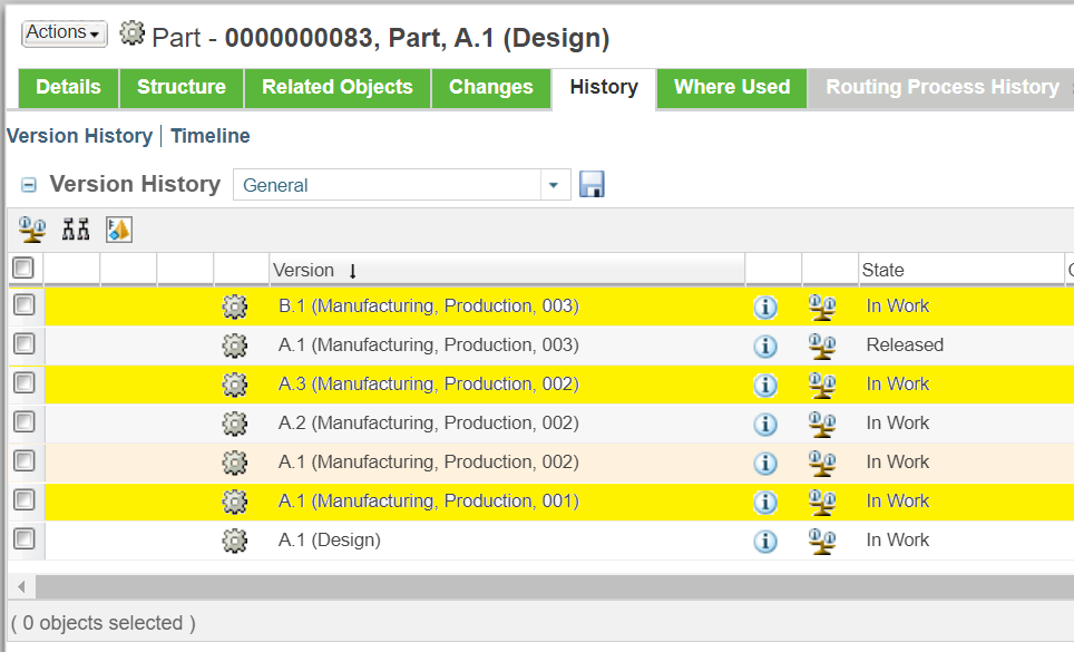

Use Case: I want to get all the latest version of manufacturing alternate BOM created in windchill.Please find the attachment for the output requirement.
Description:

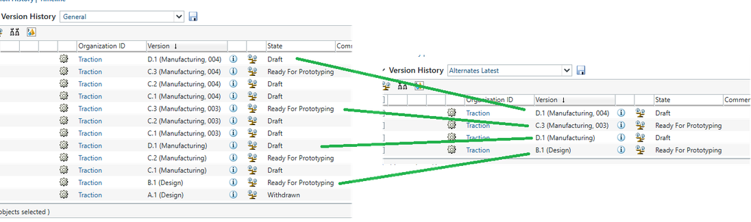

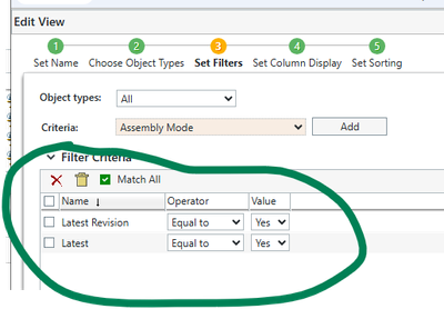

The "General View" shows all version of a part. To show only the latest versions from a view you can create a new view (called "Alternate Latest") which can be exactly the same as "General" view with the exception that you should add some filters in plus at step "Set Filters":
Result:
Created filter can be exported and reimported during build if needed.
