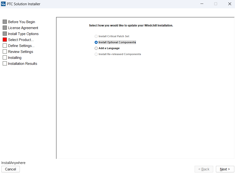

Dec 4, 2024 4:46 AM UTC
Index Search Module Unable to Install
I run setup.vbs
Update Existing Installation.
I can not find Search Index Module to Install, see

Dec 11, 2024 7:39 AM UTC
Hi @KG_11714884
I am sure that you have to chose the standalone installation, not update existing.
Then you just have to configure the Windchill installation to use the index search.
Installing the Index Search Server in Standalone Mode

HelesicPetr
Hi @KG_11714884

9-Granite
Dec 11, 2024 10:51 AM UTC
Hi @HelesicPetr ,
Thanks. I managed to install Index Search Module.
I was doing update existing one.
Since it was already install hence unable to check the box (Client).
To install server need to do new installation and then standalone installation.
