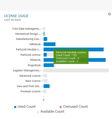

License management is done at the site level, but is there anyway to give someone access to the license information page without being a site admin? Their goal is to be able to see how many licenses there are and how many are available. Won't need access to load license file.

Oct 6, 2022 2:13 PM UTC
If you enable Windchill Performance Advisor, in the relevant dashboard you can see allocated licenses versus available licenses

Sep 21, 2022 5:36 PM UTC
Yeah, I can see why the limitation is there, but I guess what I'm looking for is a report of license usage at the org level.
Feb 24, 2023 7:08 PM UTC
As of 11.2, you can allow license management utility at the organization level by enabling the preference at site level.

MarcoTosin
