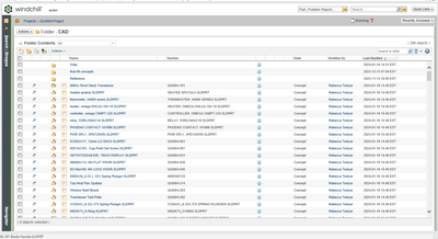

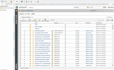

One of our users has reported her "open in Solidworks" icon has disappear from  a Project commonspace.  It's present in Products, just not in Projects.  Anyone ever experience this?  The first pic is how it usually looks, the second is what it looks like now.

Try this.
  • Please add the solidworks file from projectlink in workspace.
  • Open that file.
After opening , return to project link folder. You might have "Open in Solidworks" action available.
Please let us know.
Thanks.  We'll give it a try and will report back.
@MikeMarcoux @Ajit_Kulkarni
I was thinking if the Workspace View "All" still has the column "Open in CAD"(Something like that). If the above method did not work, please check this what I mentioned.
I might have sounded silly., just thinking aloud.
Best Regards
Hari
Thanks Hari,
We'll take a look.  It's an odd occurrence for sure.
