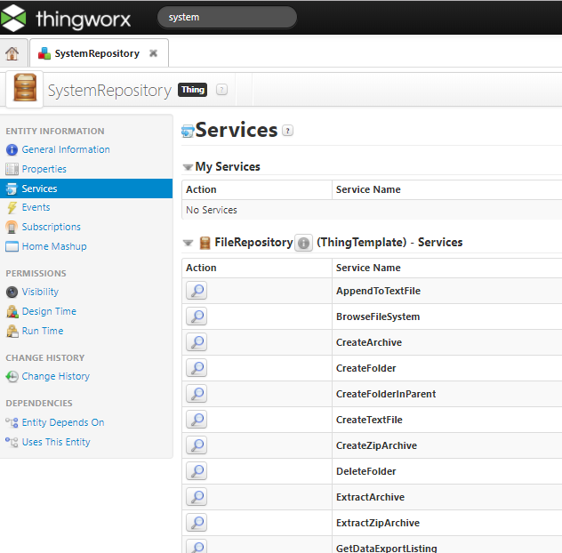

Enable to access documents from a Thingworx mashup, what folder in the ThingworxStorage directory should the documents be placed.
January 8, 2018
Randy Sandum​: With the details provided it is difficult to understand your use case on accessing document. However, I believe you can use the File Repository and create your own ThingWorx repository folder using System Repository (ThingworxStorage\repository folder ). There are couple of useful services which can be used to build solutions as per your need.
