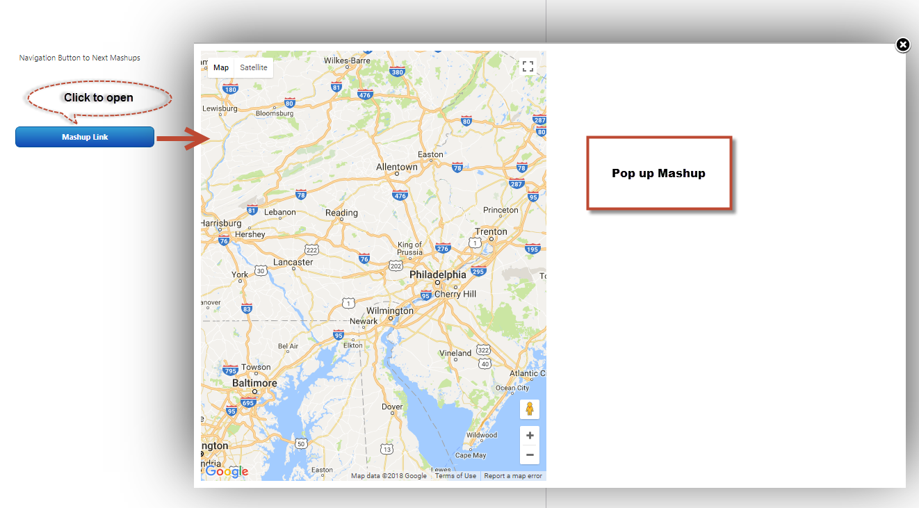

Hi All,
I am trying to add some navigation in my page, but I don't have a clue how can I do this...
I would like to have button that update my page to another one.
Any tips?
Anselmo.
Best answer by supandey
Hi Anselmo, not sure if you have already tried this but you could use the OOTB Navigation widget button allowing you to navigate to different mashup on the same mashup or as a pop up or new a new window whatever way you need it. A navigation button widget configured to open new Mashup as a pop will look like this. You can see Help Center doc for more information on it's property on Navigation Widget
Hope this'd help.
supandey5-Regular MemberAnswer
January 8, 2018
Hope this'd help.
asaito-31-VisitorAuthor
January 10, 2018
Yeah! That's it. Thanks!
