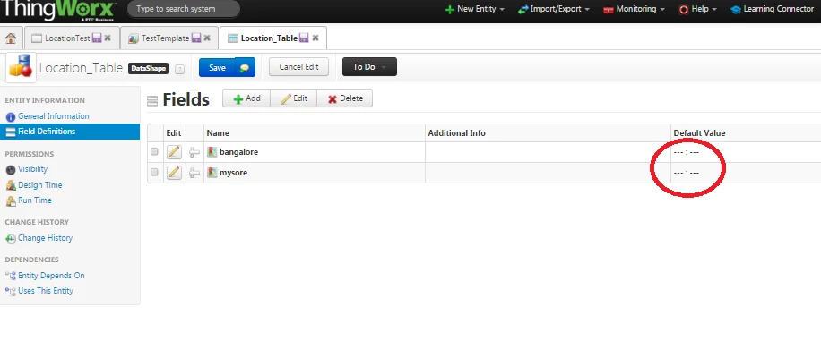

Hi.
I want to Display multiple Locations on the Google Map.
Now, for multiple Display
I have Created an infotable with 2 Locations, keeping Base Type as Location, ​but its not  accepting the Default values once it is saved.
[I have to bind these data's to google map to display Locations]
how can i get it..?? can any one suggest me..?
Thanks.
November 2, 2015
Arpitha, setting default values on a DataShape should reflect on the Infotable to which the DataShape is currently assigned too. For example, if you open your Infotable property and add/ set values/ entries, the default value you've set in the DataShape should be there.
November 3, 2015
Hi Aanjan, Thanks For your reply.
As you have mentioned above i am getting the default values in the add entries of infotable Property.But when i am binding all data from the service GetImplementingThingsWithData to the google map. I am unable get this Infotable name in the LocationField of the google map property.
How can i get this Infotable name there..?
November 3, 2015
Arpitha, although GetImplementingThingsWithData will list the Things associated with the Template along with properties and values, what you need here is a service like GetProperties which would retrieve your properties associated to that Thing specifically. You can then either bind this Infotable property directly onto a specific data point on the widget, or drop all data onto the widget. Now LocationField should be available in the drop down menu.
