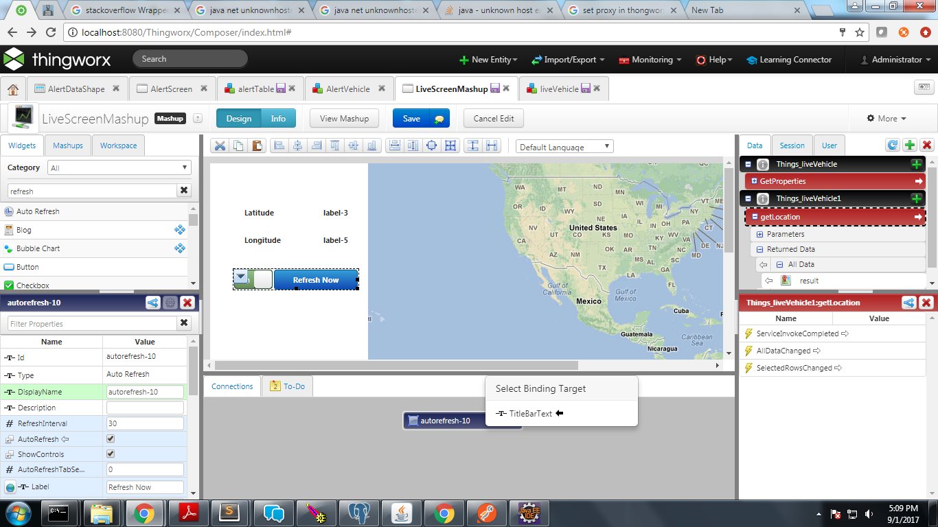

My thing's property (of location type ) is bind with map . And i am changing it's value through REST api call. How can i refresh location in map widget without loading  whole page.

Hello Prabhat,
You can use Auto Refresh widget and bind it to the service which you are using to assign location to map.
You can configure it in two ways:
1. Refresh location on click
2. Refresh it automatically in some intervals (not recommended in your use case)

I am not able to bind service with auto refresh widget.

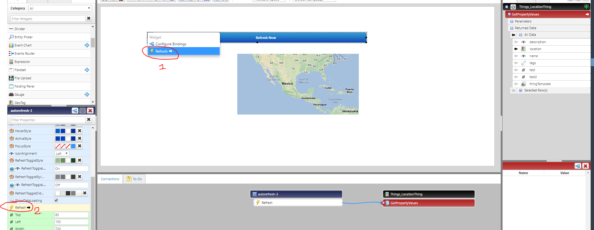

Auto Refresh widget has it own event called ​Refresh.​ You need to bind it to your service, not service to the widget.
You can bind this event from drop-down hidden menu in the left top corner of every widget (1) or from Auto Refresh properties (2).
Take a look on the biding in the bottom pane also.
