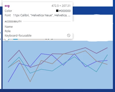

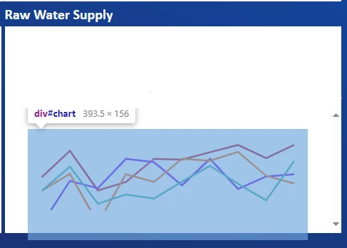

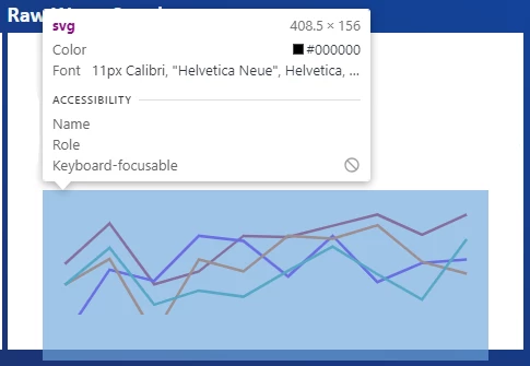

Can I adjust padding of LineChart Widgets?
I have limitation of area
I have to custom adjust padding
and I have to set height of this (am not sure it's "svg" or "#chart")

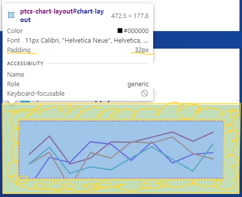

Hello @AL_10742319 ,
This is previously asked question and has been resolved. Kindly check the community post for the same:
https://community.ptc.com/t5/ThingWorx-Developers/Line-Chart-Padding-Issue/m-p/766252#M55995%3Fsource=search
also, you can try using the Custom CSS :
ptcs-chart-line::part(chart-layout) {
 padding: <padding_value>;
ptcs-chart-pareto::part(chart-layout) {

8-Gravel
Apr 9, 2024 7:35 AM UTC
Thank you for answer!
now I can adjust using the Custom CSS :
 padding: 0;
 padding: 0;

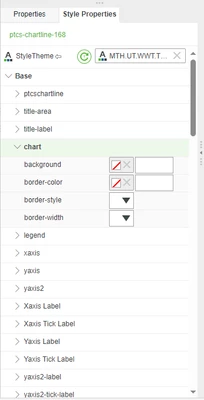

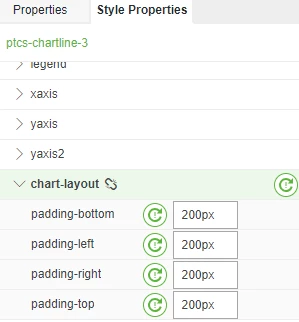

Hi @AL_10742319,
Have you enabled SparkView for Line Chart?
Have you tried configuring the paddings in Style Properties > chart-layout?
8-Gravel
Apr 9, 2024 7:34 AM UTC
I have enabled SparkView, but in Style Properties don't not have chart-layout

Support
Apr 9, 2024 7:54 AM UTC
Great! looks like the padding is exposed through Style Properties > chart-layout since TWX 9.3.4, so it's not available in older versions.
