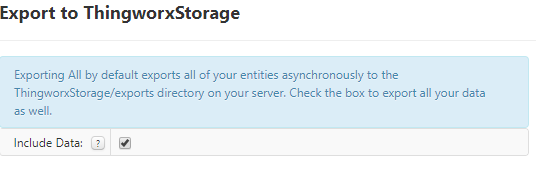

Hi, i'm install ThingWorx on the other PC
and export to storage before ThingWorx
after import from storage where copy export to storage file
but anything aren't come in Thingworx
how to move all data ?
thanks

Hi Seonho, could you please which exact export option was used? Were you also exporting the Data together with the Entities? Was there any issue during the export process?
If you looking for option to fully export from your current ThingWorx installation to your new installation together with the data, you might want to consider running Export > To ThingWorxStorage together with the data like so. This  should get you all the entities together with the data stored within the dataTables, ValueStream, Streas, Blogs, Wiki

Hi, Sushant Pandey
Yes i checked that option
but didn't import from Storage

So just to understand it right your export together with the data was successful, but when you attempt to import using those exported entities you do not see any entity or data within those entities in your new ThingWorx Server? Could you please check the export logs and also the import logs (both should be in the Application log) just in case if there was any error or maybe the export/import had not finished?
