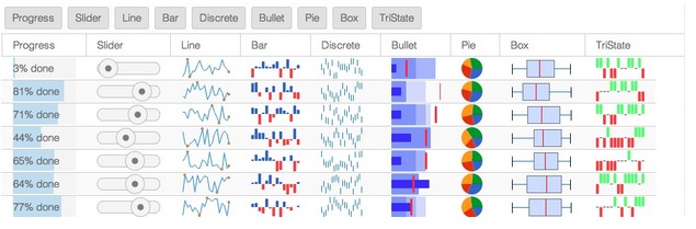

Related image
Sorry Im new to thingworx. Can u please explain how can we do it ?
I want status bar to be displayed in grid like shown in this picture.
October 5, 2017
Again with the Repeater Widget, basically Repeater Widget it's a Table of Mashups, then on each row you have repeated Inner Mashup .
