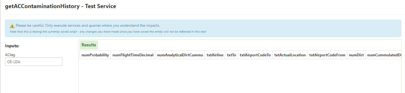

Hey Sushant Pandey​,
the variable thingname is definitely getting the right value. I have already tested the function with a valid thingname input and what I am getting is
a empty result table:
