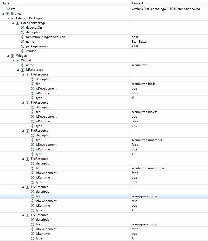

I then adapted the code above into Eclipse Java EE IDE. I linked the 3 javascript libraries in the metadata.xml, as showed in the "Include libraries.PNG" attached file (same as jquery has been applied to include the 2 other libraries).

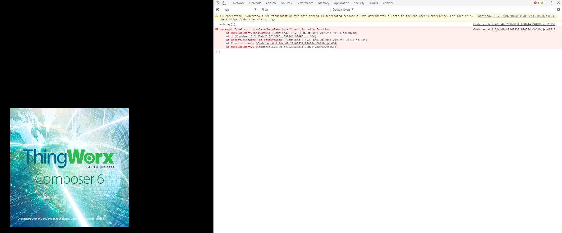

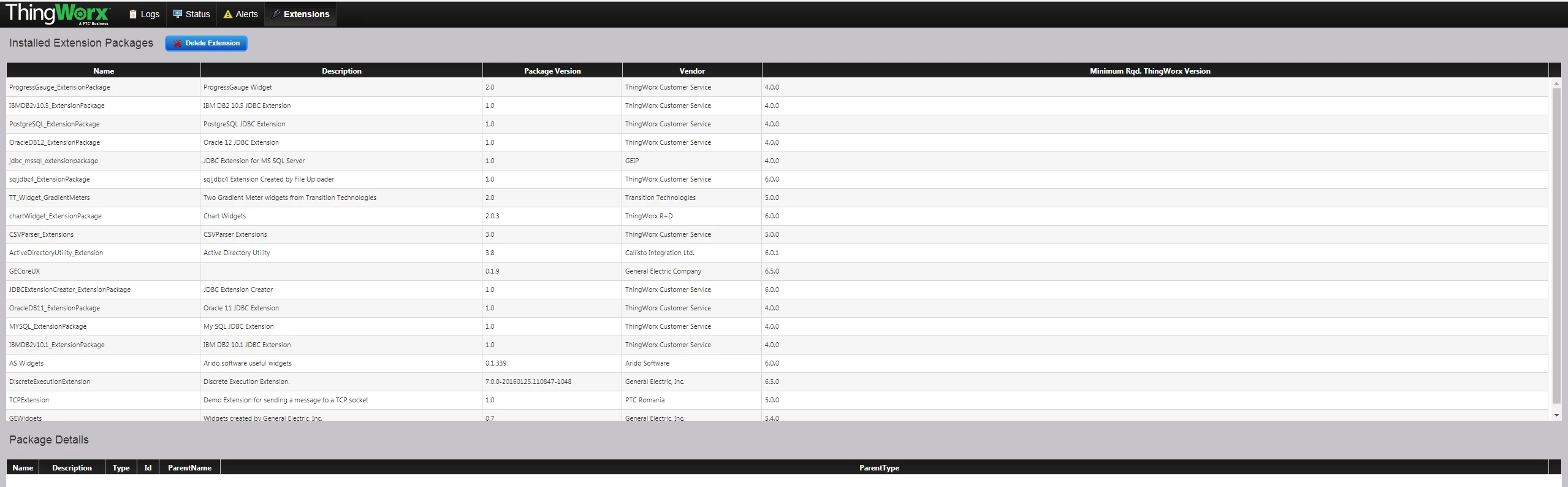

I then imported the extension into ThingWorx Composer, but the Composer was not accessible anymore after the include (see "AccessComposer.PNG" attached). There is the "Uncaught TypeError: simulatedDataTabs.hoverIntent is not a function" error, which can be related to jquery conflict. I then went to the monitoring page and more precisely to the ExtensionManagerListing (see "ExtensionManagerListing.PNG" attached) to remove the extension I had just added. This solved the problem and the Composer was accessible again.

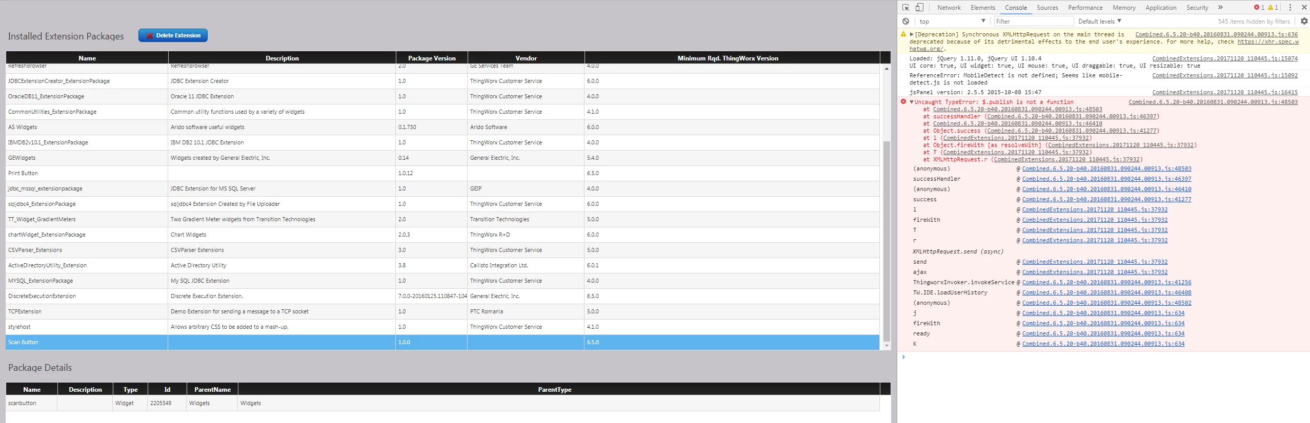

Following that, I wanted to know where did the error come from. I then only added jquery into metadata.xml, and the importation crashed again. Although this time, the ExtensionManagerListing was not accessible properly (see "ExtensionManagerListing rendering fail.PNG" attached). When I click on the delete button, the error "Uncaught TypeError: $.publish is not a function" occurs. I made some research on that and found that it can happen if there is a conflict with jquery library references. While it is surprising that an extension can cause such big problems, I think that the inclusion of my extension somehow overrides the jquery used by ThingWorx.

I noticed a bit after the importation that I made a mistake in the manner of including jquery. According to the ThingWorx Foundation Extension Development Guide page 78, a jquery library must be included by appending html and before that checking if the library already exists. So that could be an explanation on why it fails.
