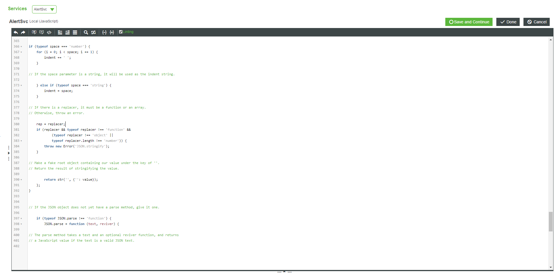

New JavaScript Service Editor
By collapsing the left-hand Navigation, Service Info and Execute/Reference areas you can give yourself a full screen service editing experience also.
Full Screen Service Editing

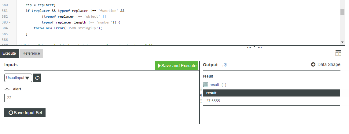

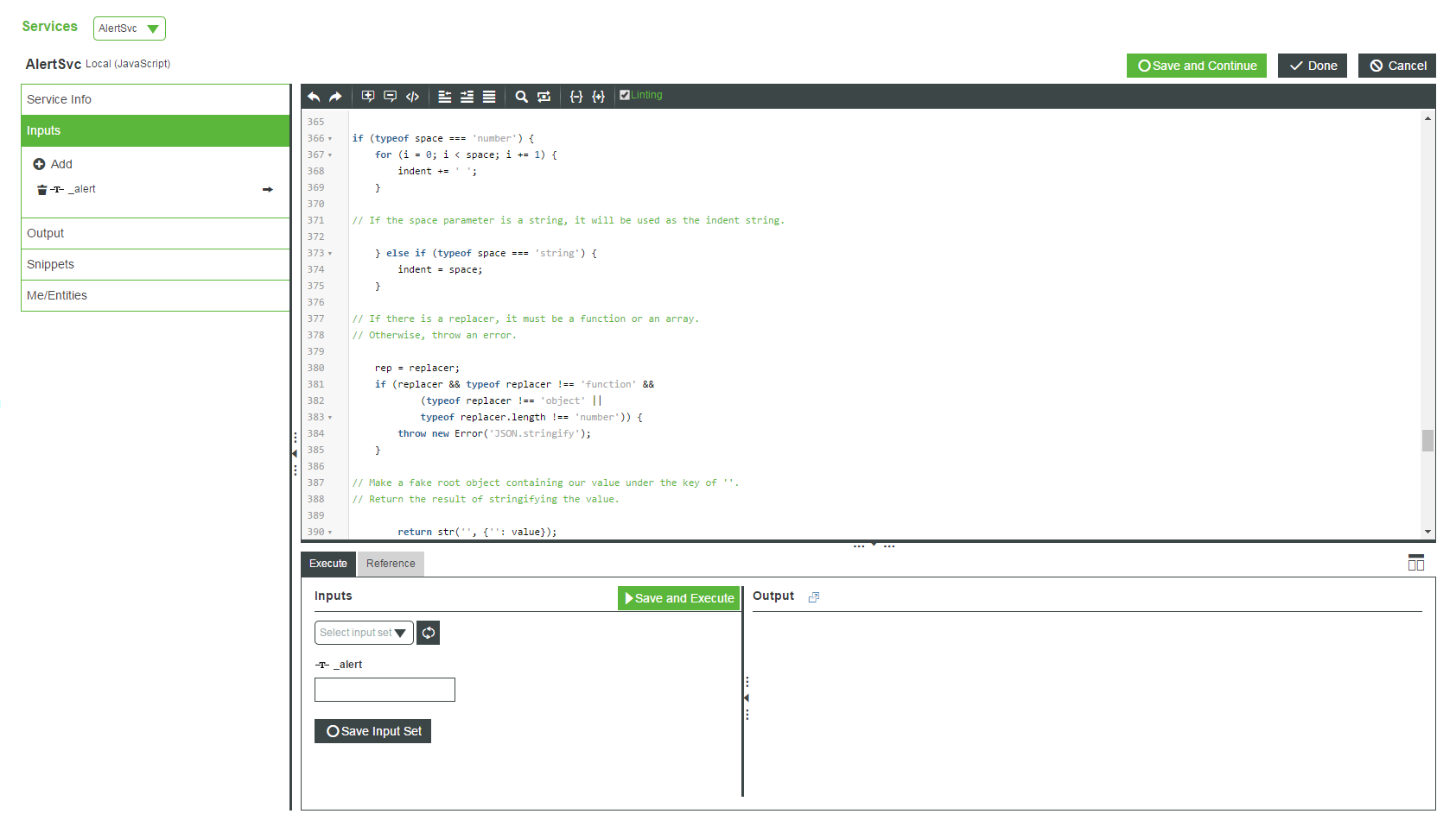

Code execution and testing
The new Execute tab is a fantastic timesaver. Formerly script authors had to leave the code editing environment entirely to test their services in the legacy Composer. This old paradigm resulted in many clicks, context switches and aggravation.  In the new Composer, you can edit and execute your code all in one spot. Now you can make a quick code change, run your service, validate the results, and make another fix all within seconds.
Service Execution tab
You can also now save your input values in the current edit session.  If there is a particular input that you find yourself typing over and over again while testing, you can now save it as a quick preference.
Saved Execution Inputs

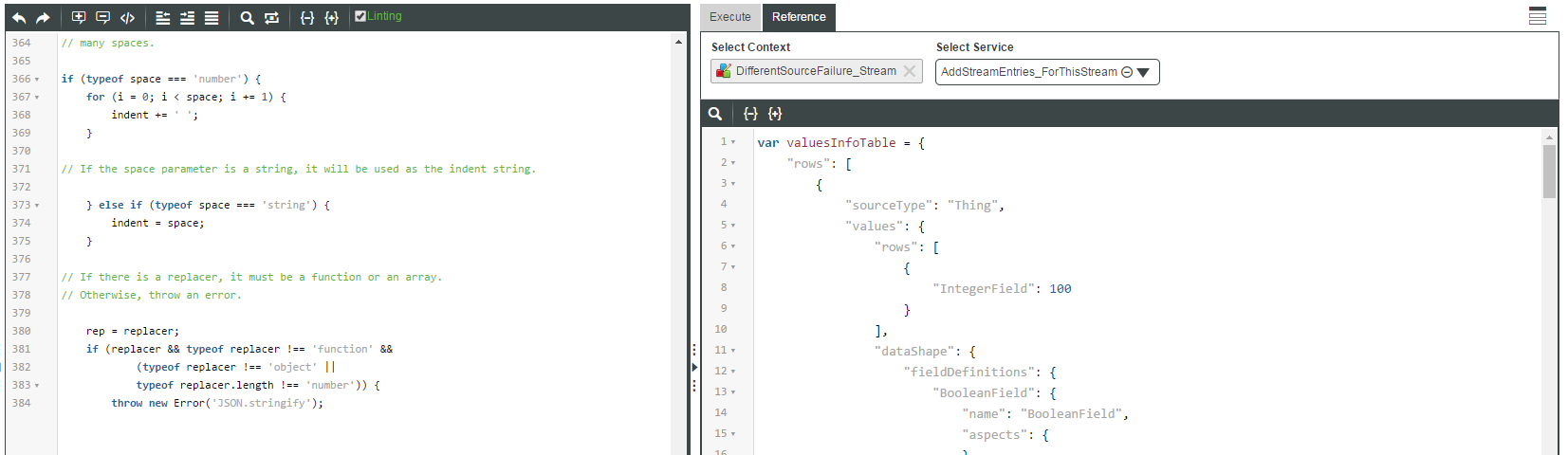

References
In the same area as Execute, there is also a new tab called Reference.  This Reference Tab allows you to browse your current or other Thing contexts for their script contents to view side by side with the script you are developing. Trying to see what a service you are calling does?  Looking to trace a bug?  Know you have code somewhere that you want to re-use?  The Reference Tab is for you!
Reference Tab side by side with code editor

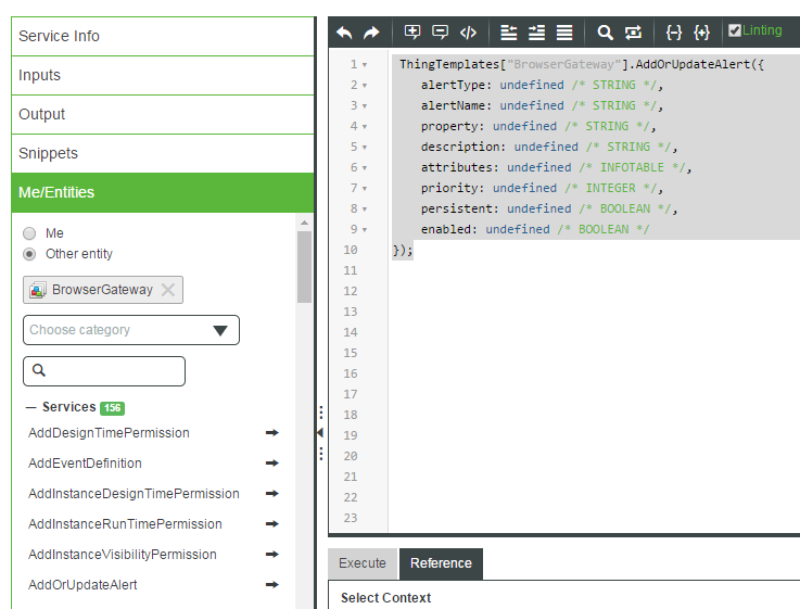

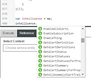

Code Completion and Me/Entities
We now offer code completion and automatic generation of service and event signatures!  To try it out, simply type “me.” or CTRL-Space after any period on a variable in your JavaScript service and see the listing of all Properties, Services and Events available on the current context.  This code completion capability is also available on script variables which are referencing a Thing, ThingTemplate, Resource or DataTable.  Select a property, service or event in the drop down and automatically a stub is inserted at the cursor position with the correct function parameters and data types (if applicable).
Code Completion available in Script Editor
You can also use the Me/Entities feature to add references to properties, services and events in your script.  This is a complementary feature to code completion, as it allows you to browse other Thing contexts to reference in your script.  As with code completion, you can generate a stub of the method and its parameters within your code easily with a button click.
Me/Entities inserting service call stubs

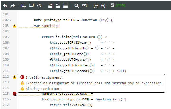

Linting
At the top of your service editor toolbar, you’ll see a new check box which is for Linting.  This is a great feature which interprets your JavaScript while you code and finds syntax and other common errors.  In the legacy Composer, some syntax checking was performed but you only learned of errors when you tried to save your script.  We’ve enhanced the error checking rules and also alert you to issues as you type with error/warning icons in the left line number area.
Linter warnings and errors

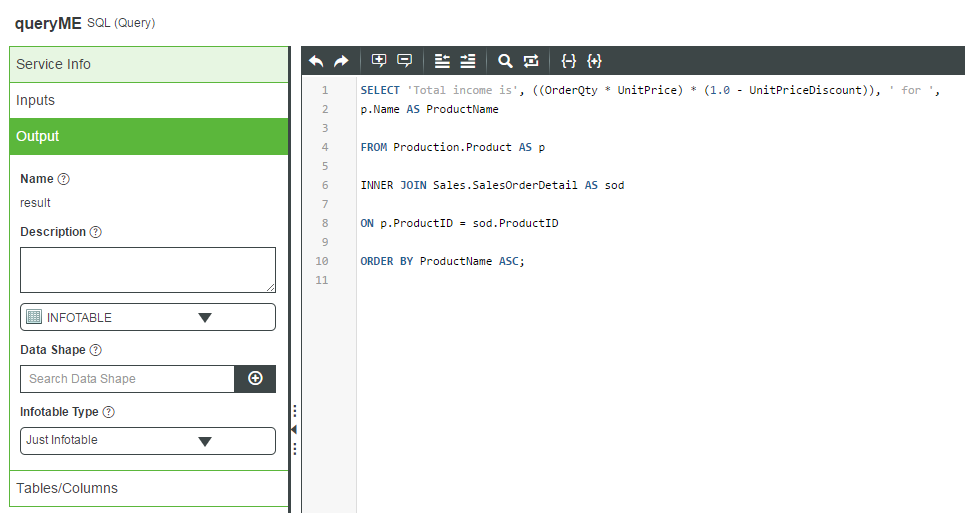

SQL Services
We’ve now added SQL Query and Command service capability to the new Composer.  You can also generate a DataShape from your query result sets.
SQL Query Services

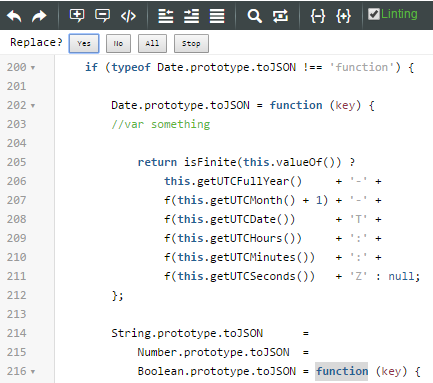

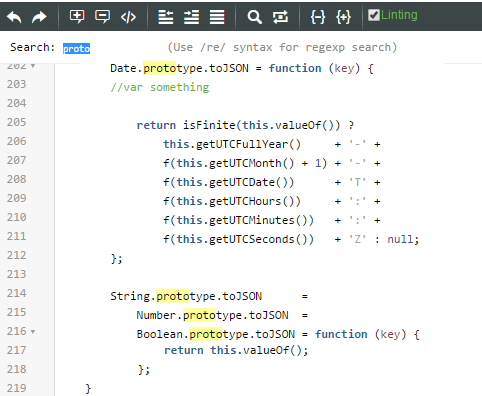

Search and Replace Enhancements
Search in script editing is now improved with result highlighting and it supports regular expressions.  This is a lot more user friendly and we support many key commands and shortcuts through our use of the Code Mirror editor.  View this list of available commands.
Search with result highlighting
Search/Replace of a term
