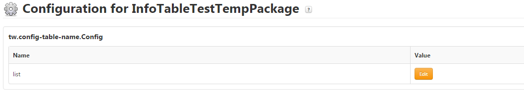

I'm trying to put an InfoTable into a ConfigurationTable of my custom extension. But when I upload it to the ThingWorx platform no DataShape is available for the InfoTable, so I nothing can be inserted. The DataShape is on the ThingWorx server.
The Code looks like this:
@ThingworxConfigurationTableDefinitions(tables = {
  @ThingworxConfigurationTableDefinition(name = "Config", description = "", isMultiRow = false, ordinal = 0, dataShape = @ThingworxDataShapeDefinition(fields = {
  @ThingworxFieldDefinition(name = "list", description = "", baseType = "INFOTABLE", ordinal = 0, aspects = {
  "isEntityDataShape:true", "dataShape:testShapeInf" }) })) })
When I add a property with baseType INFOTABLE it woks fine, but not with the ConfigurationTable.
Has anybody experience with this?

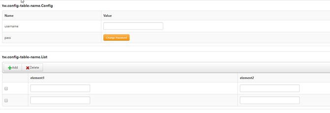

Another much better alternative is to use a separate Configuration Table for the Infotable property, and declare it inline.
Something like this:
@ThingworxFieldDefinition(name = "username", description = "", baseType = "STRING", ordinal = 0),
@ThingworxFieldDefinition(name = "pass", description = "", baseType = "PASSWORD", ordinal = 1)
@ThingworxConfigurationTableDefinition(name = "List", description = "", isMultiRow = true, ordinal = 0, dataShape =
@ThingworxFieldDefinition(name = "element1", description = "", baseType = "STRING", ordinal = 0),
@ThingworxFieldDefinition(name = "element2", description = "", baseType = "STRING", ordinal = 0)
This would cause the UI to look something like this:

Thanks for your answers.
For me the approach of Jakub Kaczynski​​, that you manually apply the DataShape to the ConfigurationTable, works fine. You just have to save the ConfigurationTable and restart the Thing by calling the methods:
this.SaveConfigurationTables();
this.RestartThing();
This works also when isMultiRow is set to false.
I also used your suggestion, Petrisor Lacatus, using a separat ConfigurationTable just for the InfoTable, with isMultiRow set to true.
