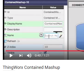

From the video we see a selection button:

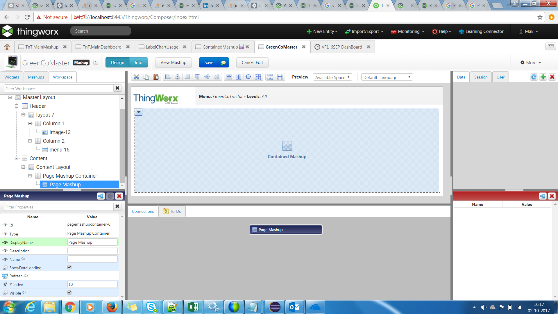

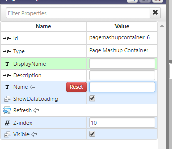

In my instance, we see there is no option:
Any idea why?

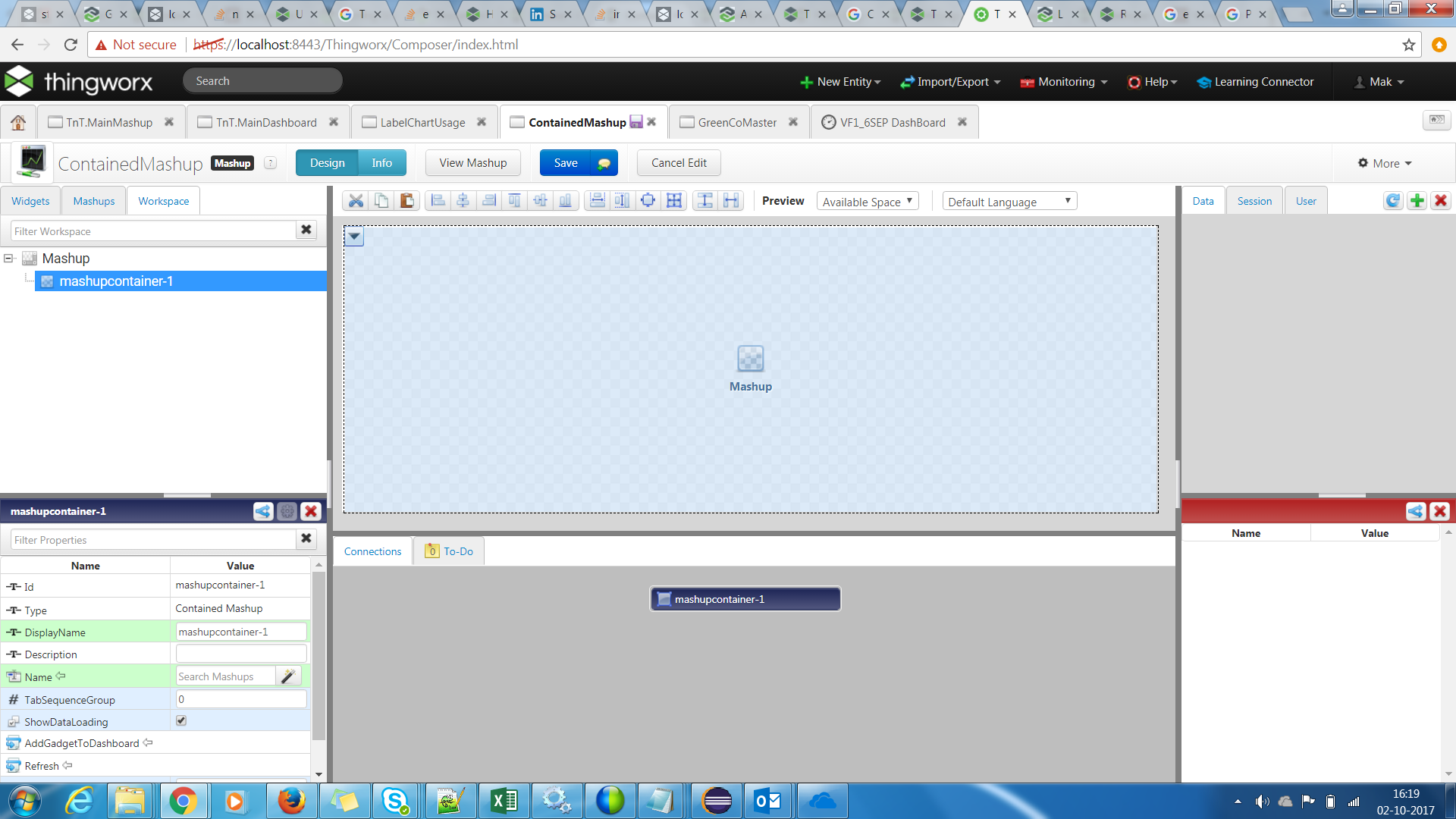

I'm attaching a sample ContainedMashup - please note the connections after the import.
October 2, 2017
I think in your instance you are having a contained mashup in a master mashup,i tried the same combination in that case there is not name selection .
But normally when i insert a contained mashup widget in a mashup then you get an option for selection of a mashup as contained mashup .Like this
I hope it's clear to you ,do let me know if i did not get your question in right direction

Thanks for the reply. Yes I am creating a Master with a Contained Mashup:
How do I get another Mashup to occupy that container?
Would it help if I described what I am trying to do in a separate post?
Thanks!
20-Turquoise
October 2, 2017
You would go to the mashup that you want to have the Master and select "Master mashup" name there. Similarly,  when you want to view the mashupmaster at runtime, you'd have to view the mashup rather than the master.
