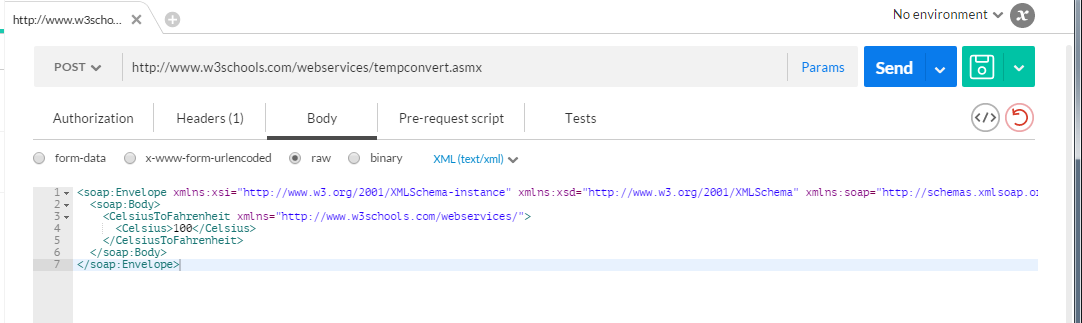

What I'd like to do is the equivalent of this
Where the XML is submitted as the body of the request rather than as a parameter as I thing that Thingworx is struggling with the length of the XML I'm using.
August 10, 2015
For you to pass the body defined in Postman to your service you need to provide the postParameter=name_of_input_parameter_to_service segment to the URL; this will tell the REST call that you want the body you are providing to be posted to the input parameter of the service you are calling.
What you have in that screen shot is fine, just add that segment I bolded above (where name_of_input_parameter_to_service is your predefined input parameter)
Do you have an input parameter to your service of base type XML? If not you need to add one to accept the XML content.
