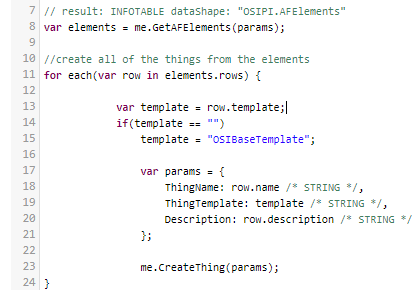

I have creating things using script and when i go to view one of the new things this is the message i am seeing; Encountered an error retrieving UKPN - : :
any ideas on how i can fix this? what might i have done wrong?
This is the script i have used:
Andy

Hi Andrew, for one I would have createThing service surrounded with Try/Catch to ensure things really get created. Just curious are you able to create this particular thing manually which was created programatically?
