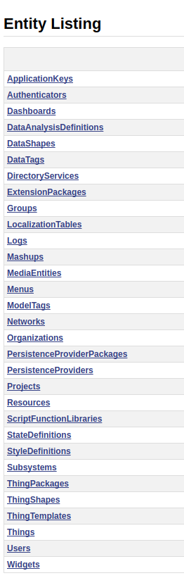

I am creating custom file repositories for each of my customers. The aim being to allow them to upload an image file to use in some mashups. The problem I have is in being able to create an image link to those files. How can I create URL for my custom repository and the files?

thanks for the reply. I tried the URL you suggested, but couldn't get the correct path to the repository. I used the REST API to get to the entity listing but couldn't see any file repositories?
Decided to go with your suggestion of using LoadImage and a value display widget which seems to works for me. Thank you.

As for the entity listing, the file repository thing resides under things because it implements FileRepository thing template which in turn implements GenericThing.
/Thingworx/FileRepositories/<YourFileRepositoryThing>/<YourFile> is the URL for the actual file saved in the file repository. So this is what you should use as the property value, if you were to go with my original suggestion. I'm glad you made it work anyhow.
