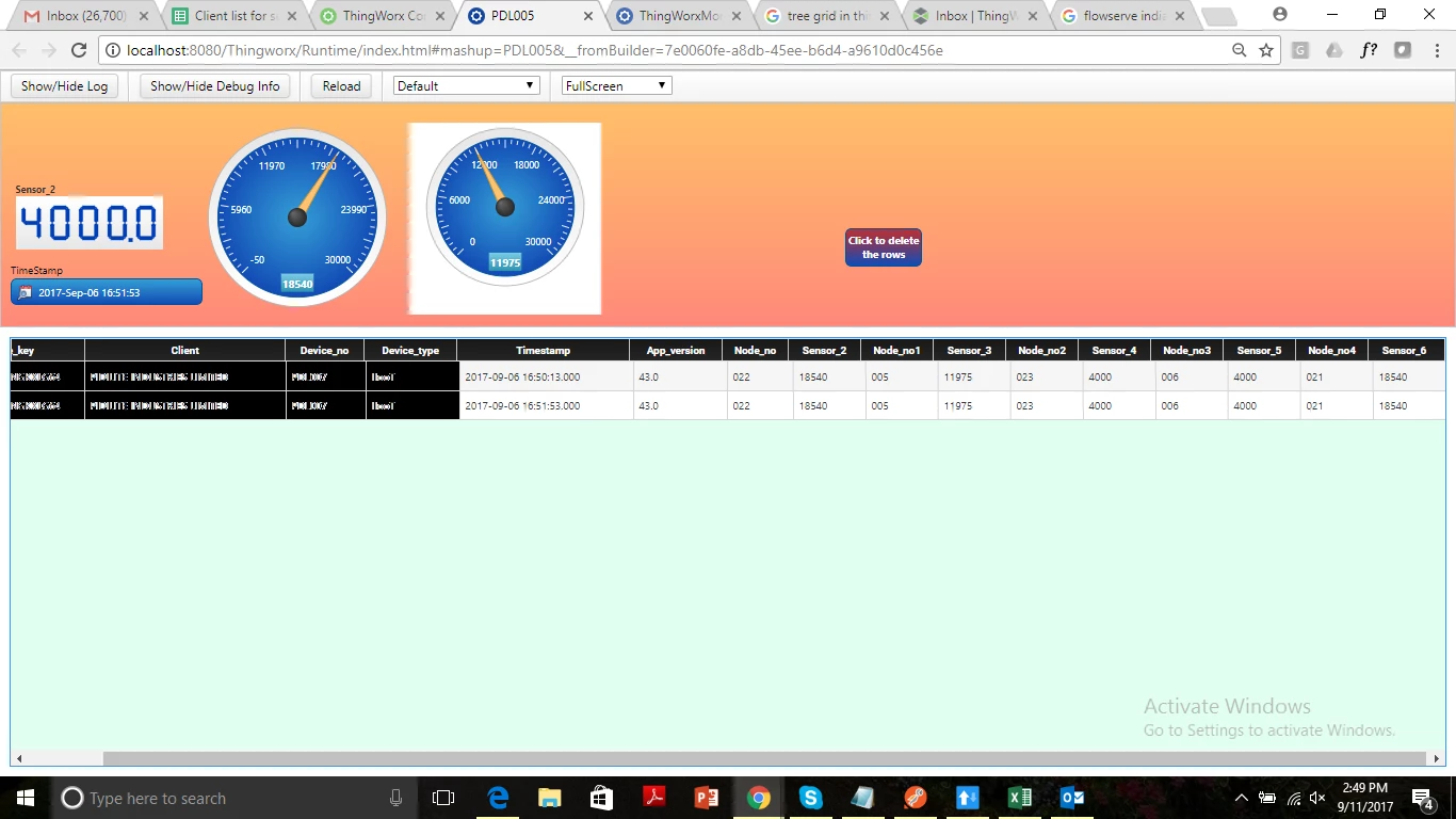

Am sending the json data through the Post method via rest API URL and it is displaying on grid by using getDataTabeEntries service. now i want to create a chart by using two columns of data from the grid on the mashup. but am unable to create anytype of chart by using that data.
i want to show the values  chart of sensor value of a temperature and timestamp .
can anybody please help me out?

1 screen shot : The data is displayed on the grid, from that grid i want show the timestamp and sensor_2 value on the graph.

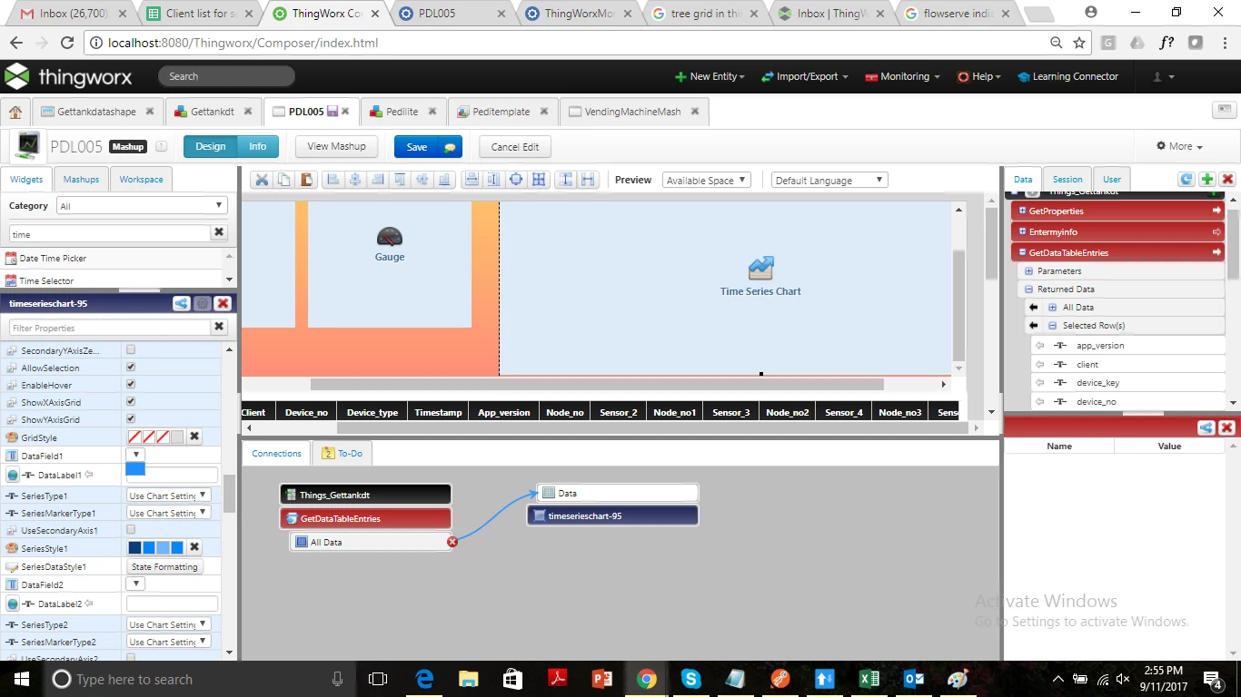

2. screenshot  : I have bind the data and you can able to see the connection also from the getDatatableEntries service. and in the property configuration, i can able to see only the time stamp field in x- axis but no other fields in the the data fields of y-axis

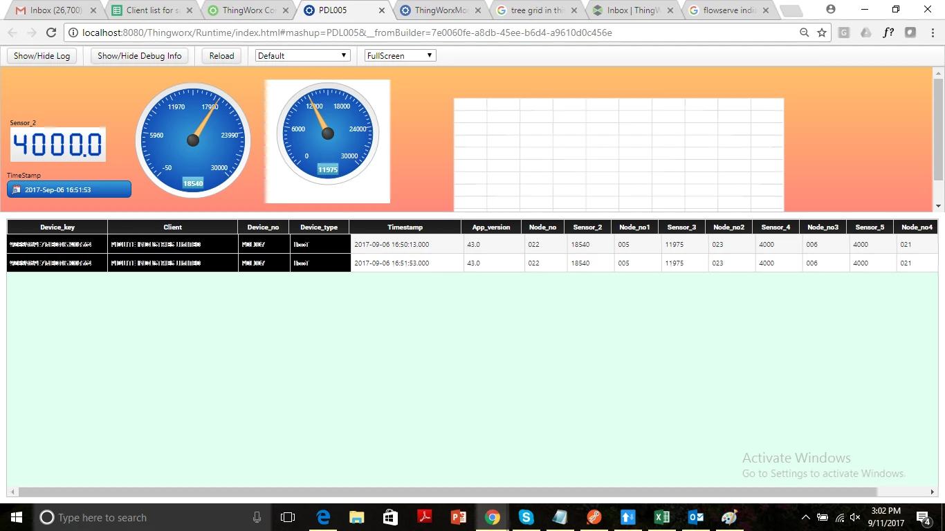

3 screen shot : i get empty graph with no single value.
September 11, 2017
Please specify in the service data shape for the infotable, then try to drag again, you should have options in the list
