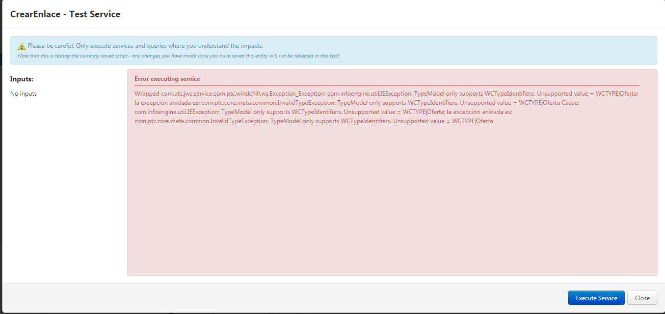

Hi. I'm developing a custom application on navigate and i need to create a link between two objects using the "Link" service, so I created my custom service called "CrearEnlace" to test it but It doesn't work, when I invoke the service the next error occurs
Do you guys know how can  I execute this service in the right way? Thank You from your time.

Are you able to share the contents of your service?

    This is my custom service code, Here I fetch an object which represent the child and after I get the result I try to create the Link with another object which is the parent.
     var params = {
        infoTableName : "InfoTable",
        dataShapeName : "SingleValueShape"
        // CreateInfoTableFromDataShape(infoTableName:STRING("InfoTable"), dataShapeName:STRING):INFOTABLE(values)
        var r = Resources["InfoTableFunctions"].CreateInfoTableFromDataShape(params);
        r.AddRow({
        value:'VR:wt.part.WTPart:170623'}
        params = {
        ufids: r /* INFOTABLE */,
        dataShape: "ptc-part-demo-shape" /* DATASHAPENAME */
        // result: INFOTABLE dataShape: "undefined"
          //Here I get the child object which im going to add
        var resultFetch = me.Fetch(params);
        params = {
        dataShapeName : "ptc-part-demo-shape"
        // CreateInfoTableFromDataShape(infoTableName:STRING("InfoTable"), dataShapeName:STRING):INFOTABLE(ptc-part-demo-shape)
        var inf = Resources["InfoTableFunctions"].CreateInfoTableFromDataShape(params);
        params = {
        associations: resultFetch /* INFOTABLE */,
        parentUfid: "VR:wt.part.WTPart:198464" /* STRING */, //THIS IS THE OBJECT I'll USE AS THE PARENT.
        dataShape: "pdl.wt.part.WTPartDescribeLink" /* DATASHAPENAME */
        var result = me.Link(params);

What does your Fetch service return? I do not think that comes OOTB in ThingWorx...
