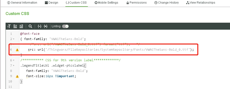

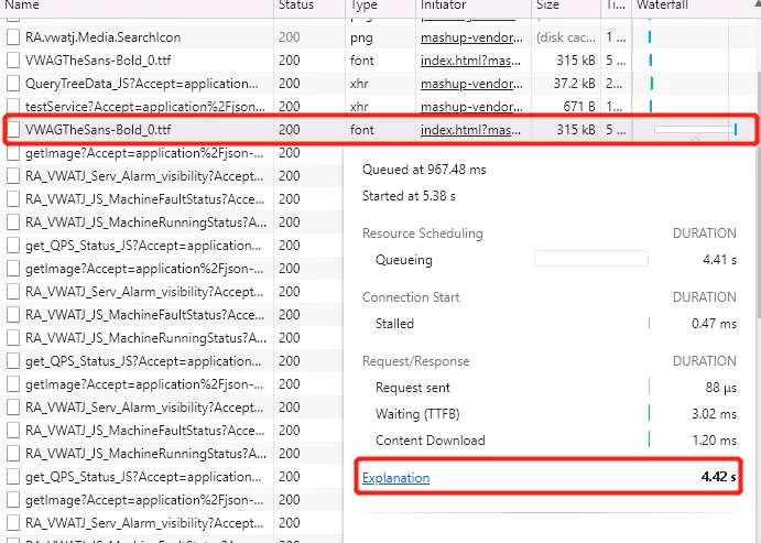

Dears,
We are using custom fonts on Mashup, but it takes a long time to display when the fonts are loaded. Please refer to the attached picture for the font loading method. Is the method we used incorrect?
takes 4.42stakes 4.42s
CSSCSS

Hello @CZ_9645217 ,
It could be an issue with the ISP. Maybe the font is retrieved from cache. Link here.
There is a good resource on how to preload or prefetch your font. Link here.
You can check one way to improve mashup performance loading. Link here.
