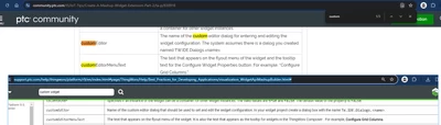

I couldn't find any documentation regarding how to use custom dialog when developing custom widgets from any of these documentations. Are there any documentation for custom dialogs?
taken from thingworx_extension_development_user_guide.pdf
  • customEditor – the name of the custom editor dialog to use for entering and editing the widget configuration. The system assumes there is a dialog named you created TW.IDE.Dialogs..
  • customEditorMenuText - The text that appears on the flyout menu of the widget and the hover over text for the Configure Widget Properties button. For example, “Configure Grid Columns.”

thanks for the information, but when it's an "Internal API" why is it mentioned in the Documenation?
customEditor
Name of the custom editor dialog that should be used to set and edit the widget configuration. In your widget project create a dialog box with the name TW.IDE.Dialogs.<name>.
The text that appears on the flyout menu of the widget. It is also the text that appears as the tooltip for widgets in the ThingWorx Composer . For example, Configure Grid Columns.
