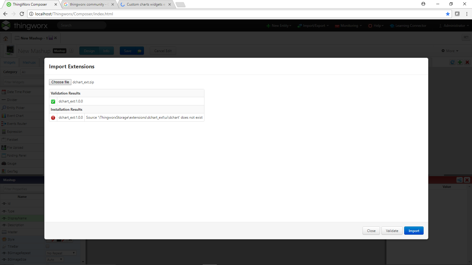

Widget successfully added for import but when i click on import button following error occur.
Help if anyone created custom widget.

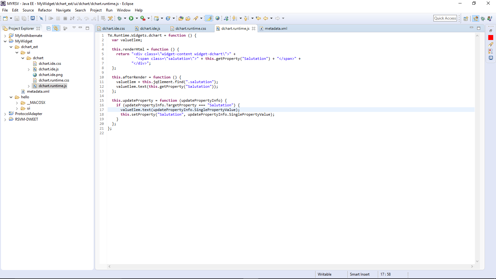

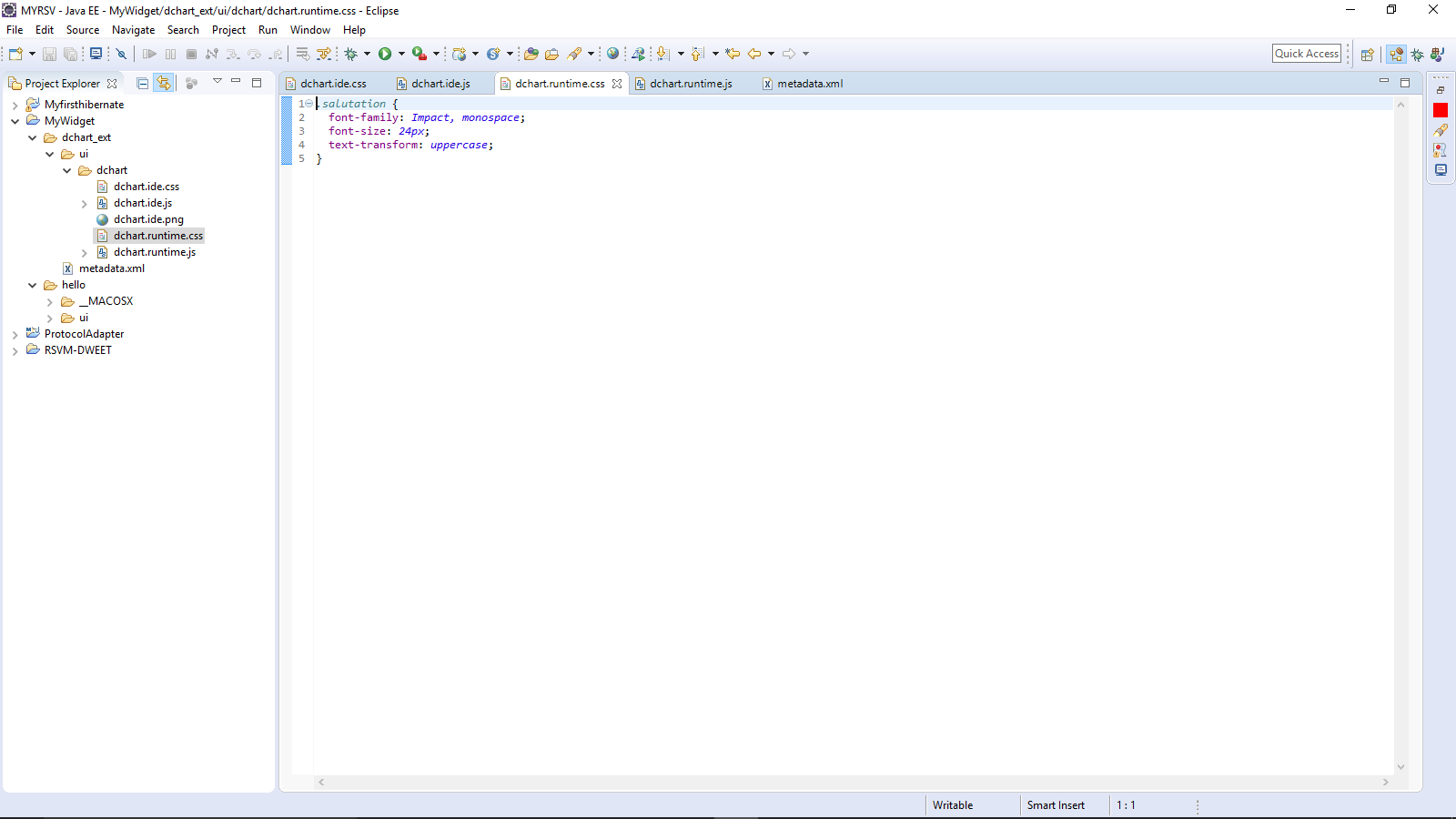

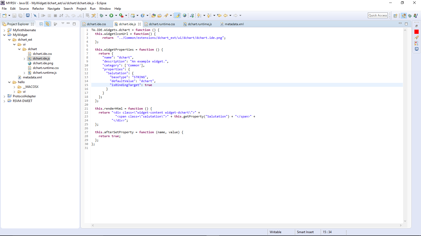

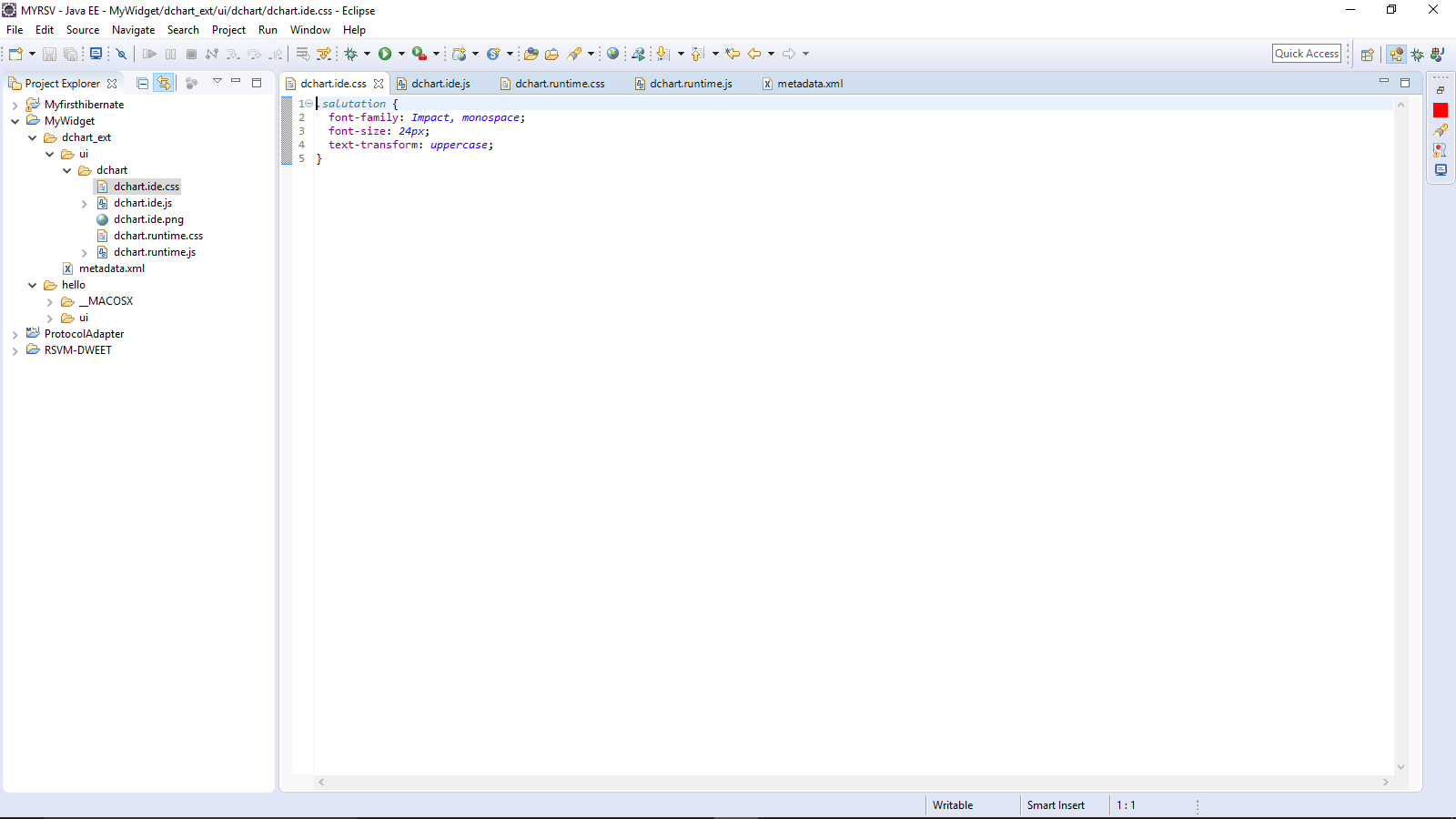

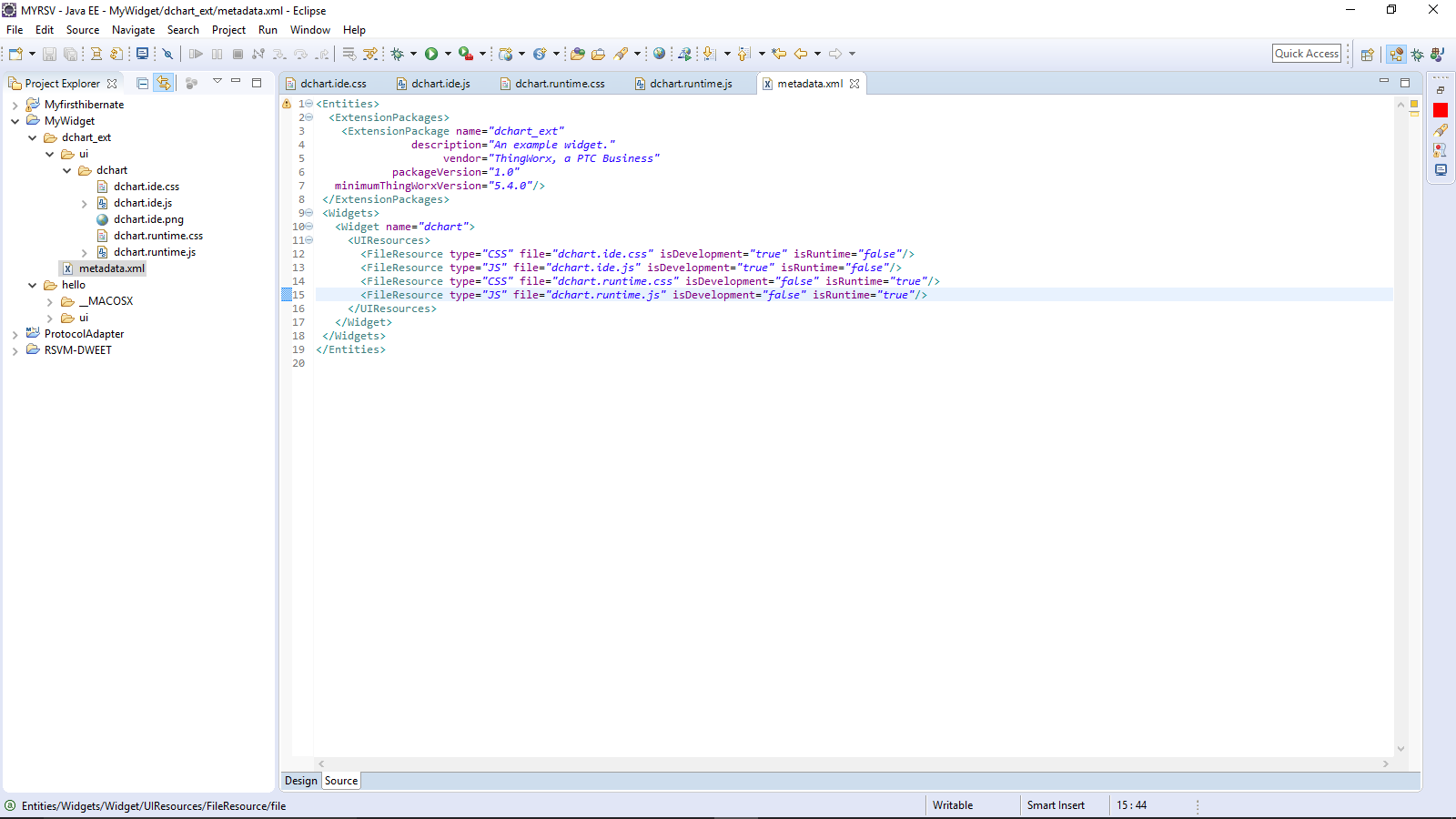

    I had take help from HelloWorld_ExtensionPackage . Here are the files which i had modify with my widget named dchart.
    Please help in resolving this.

    August 31, 2017
    Hi Yamini,
    Still getting same error.
    I had followed all steps everything is as per to the article.
