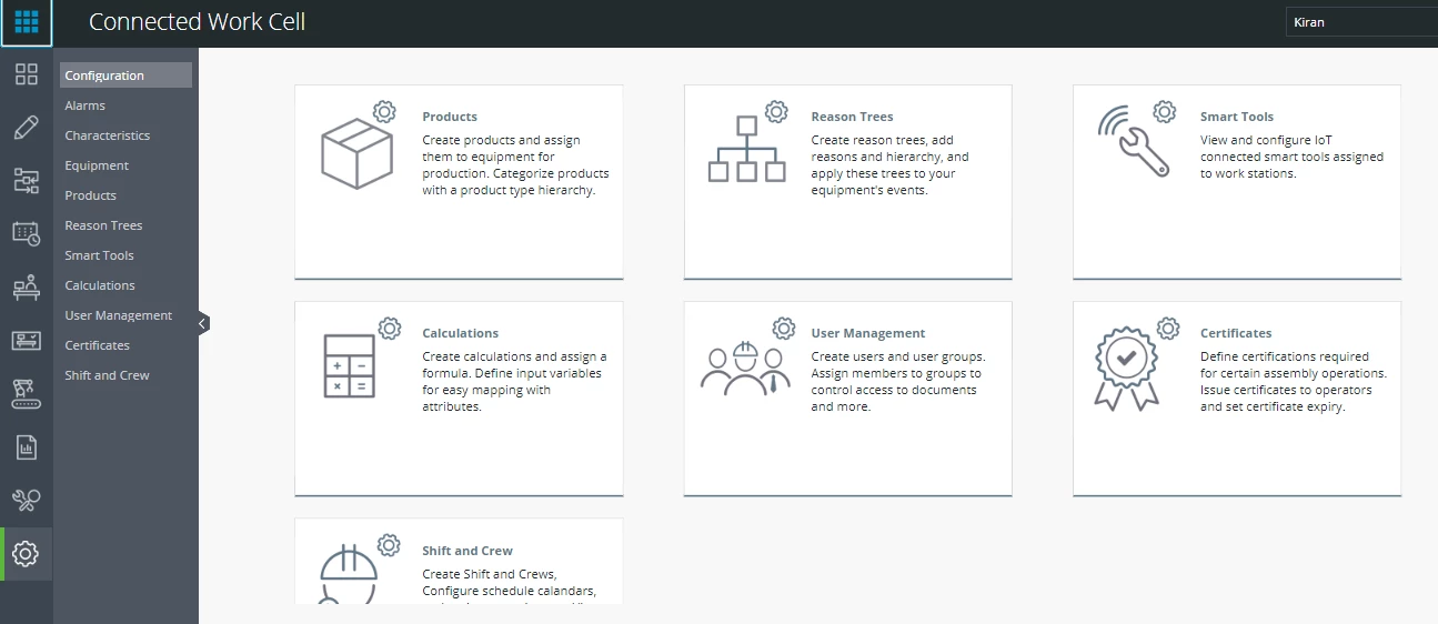

After installing CWC 9.5.0 Work Order Utilities cannot seen in configuration. Kindly check attached image

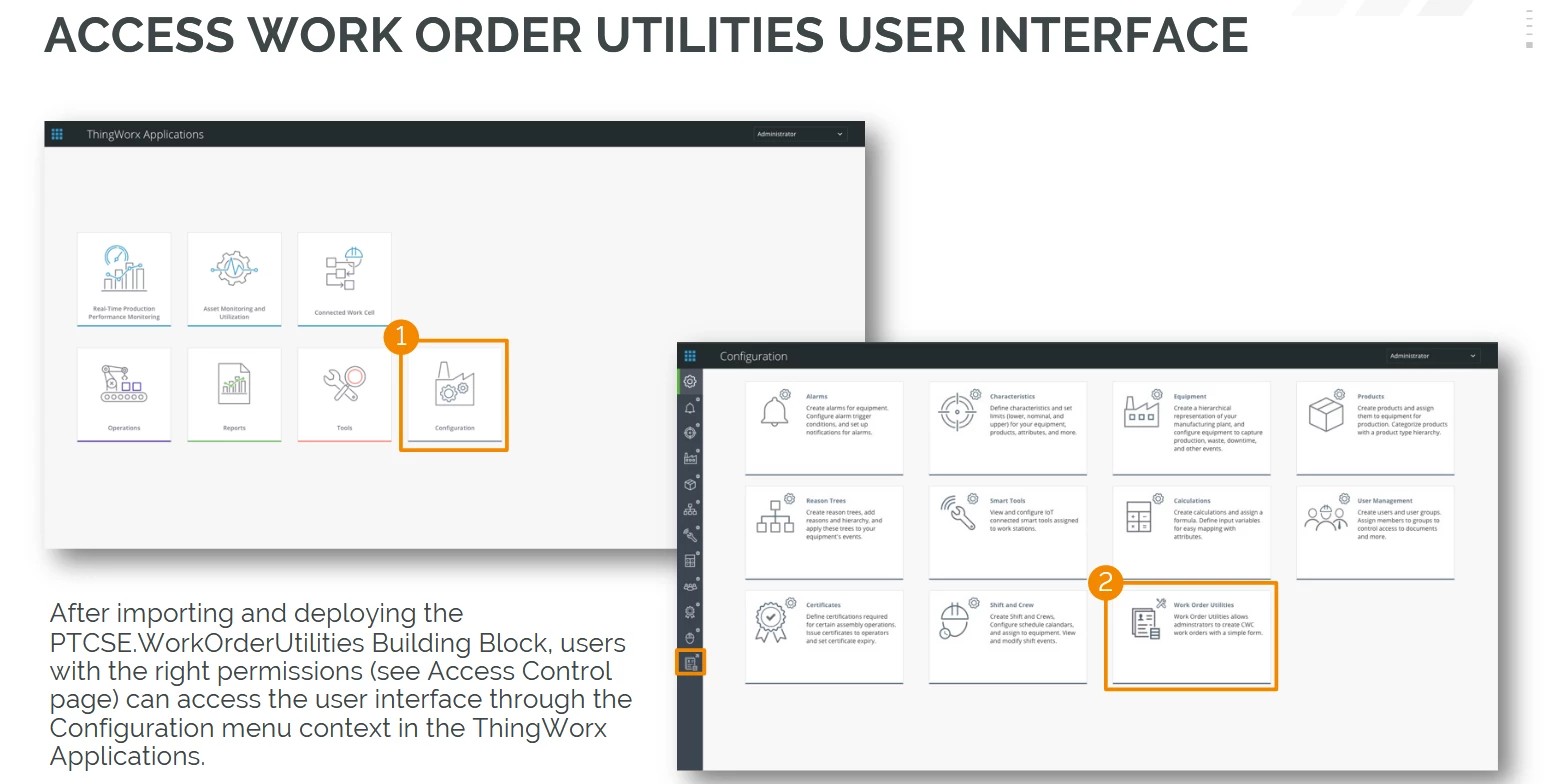

Quote: "After importing and deploying the PTCSE.WorkOrderUtilities Building Block, users with the right permissions (see Access Control page) can access the user interface through the Configuration menu context in the ThingWorx Applications".

where I get PTCSE.WorkOrderUtilities Building Block
May 21, 2024 6:40 PM UTC
You can find "ThingWorx Applications Work Order Utilities Installation Guide" in attachment.

Can you send files which support to V 9.5.0.Because we have just now upgraded from 9.3 to 9.5. It's difficult to further upgradation.
SebB13-AquamarineAnswer
May 28, 2024 1:04 PM UTC
@KG_96  I just checked the code, and it looks like the extension does not have any specific dependencies on 9.5.1. You can try importing it to 9.5.0, i just did not test it on that version.
