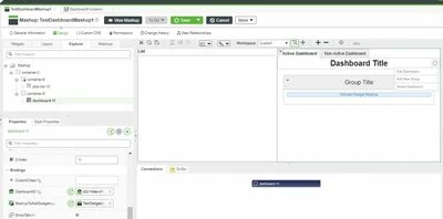

I am on thingworx 8.5, creating a dashboard as per the developer guide
https://developer.thingworx.com/en/resources/guides/customizable-responsive-ui/dashboard-finalize-dashboard
I added dashboard widget, linked a dashboard id. But when I clicked Add new Group on Dashboard options, no response from Thingworx Composer to enter group. Cant proceed further.

Hi @nhksrd
I think you miss the very last step on the previous page.
They ask to select View Mashup.
The Add Group works in the Runtime Mashup not in the Design one, your screenshot shows you are in the Design Mashup.
So select View Mashup and the Add Group should work there.
Hope this helps
Christophe

Thanks, I missed the View Mashup step.
