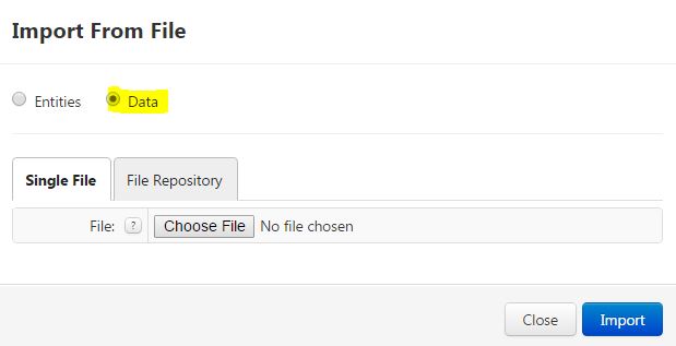

    Hi Ayushi Gupta​, Did you go to data tab and imported the data?

    Yes Ankit, I then selected File Repository. and i already have the exported data kept in the TW repo. I do in a same manner always and it should work but this time i am seeing : Import SKIPPED for entity.... type of log in TW logs.
