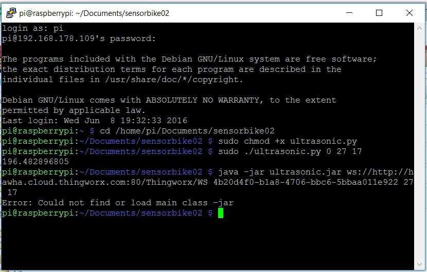

We tried to get livestream data from an ultrasonic sensor connected to the raspberry pi 3 to Thingworx. But when we try to execute the java archive, we get an error message that the -jar main class could not be loaded or found. You find this error message attached.

It seems like you have not specified the class-path correctly.
Read the Article to understand and setting of class path.
http://docs.oracle.com/javase/7/docs/technotes/tools/windows/classpath.html
Since it's well know issue which anyone faces if classpath and classnames are not mentioned   , I would suggesting looking for “Could not find or load main class” Error while running java program using cmd prompt" online to know more about this.

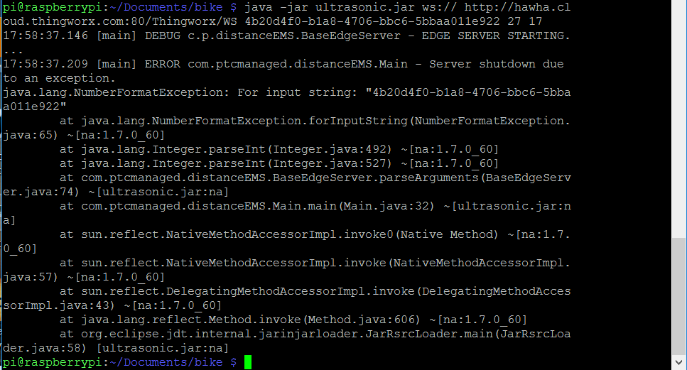

Thank you. I set the classpath right and it worked. But the output of the command does not look like it should. It appears an error that shuts down the EMS. Any further ideas to solve this issue? You can again find a screenshot attached.
Thanks in advance.
September 14, 2016
Again it throwing exception java.lang.NumberFormatException for Input String  as shown in screenshot , is this input string is appkey ? Did you copied it correctly , does it have white spaces.

September 15, 2016
Yes, this input string is the appkey. I'm relatively sure that I copied it correctly and there aren't any white spaces.
There aren't many changes I do before. I only installed java jdk7, used chmod +x on ultrasonic.py and set the correct classpath.
The command should look like this: java –jar ultrasonic.jar ws://yourInstanceURL:80/Thingworx/WS YourAppKey pinIn pinout

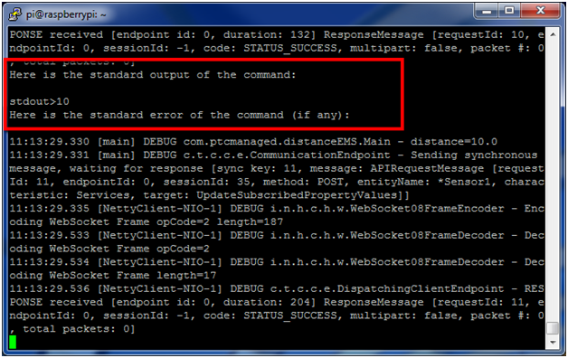

and the output should look like this:
I got this from a PTC software engineer, but his mail account apparently doesn't exist anymore.

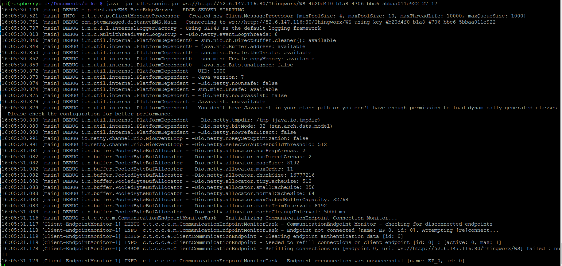

September 15, 2016
Benno Haunert​ - I believe issue is occurring due to putting http along with ws. Can you try removing http:// in your command similar as below -
java -jar ultrasonic.jar ws://52.6.147.116:80/Thingworx/WS YourAppKey pinIn pinout
September 15, 2016
The error which you are getting now is again related to classpath and/or missing jars: "you dont have java assist in your classpath or you have dont  have enough permission to dynamically load classes"
Javassist is a library for byte code manipulation.
Seems , more like environment issue or issue related with compilations and adding third party jars while making the build .
Which build tool are u using to make the jars ? if maven is being used , Please add the following lines in pom.xml and then make the jar again.
<dependency>
    <groupId>org.javassist</groupId>
    <artifactId>javassist</artifactId>
    <version>3.18.1-GA</version>
</dependency>
bhaunert1-VisitorAuthor
September 16, 2016
Thank you Durgesh Patel​, that was a good point, the connection is now successfull.
