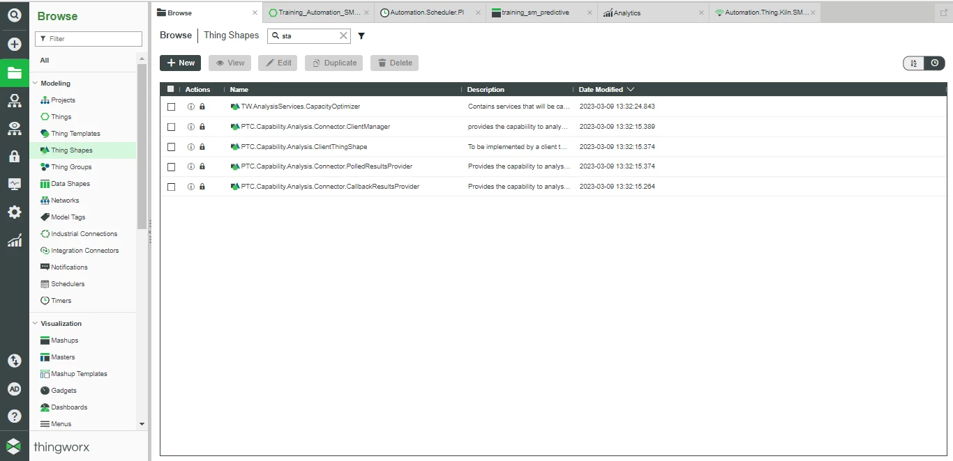

Descriptive analytics not showing
I tried to use descriptive analytics using tatisticalCalculationThingShape  and  StatisticalMonitoringThingShape but i cant find it on my thingshape. I want to use this for FFT. Could you show me how to use FFT on my thingworx analytics and provide a step by step tutorial.

oct. 18, 2023 8:30 AM UTC
Hi
Descriptive Analytics is part of Platform Analytics media, not ThingWorx Analytics Server.
So in order to see those thingshape, you first need to install Descriptive services.
The article https://www.ptc.com/en/support/article/CS299233 may be useful here.
Christophe

oct. 18, 2023 9:15 AM UTC
Hi @cmorfin ,
For now i have 2 servers for thingworx. The first one is thingworx foundation and the second one is thingworx analytics. If I want to install the platform analytics, should I make a new server, or I can just install platform analytics to the existing one (thingworx analytics server) instead?

cmorfin19-TanzaniteRéponse
oct. 18, 2023 10:27 AM UTC
Hi @A_10333884
It will all depends on the activity you have and the size of your server.
You can certainly have both ThingWorx Analytics Server and Descriptive services on the same machine at least to test it.
If you are planning on using only Descriptive Services, I would advise to unselect the property transform in the installer as this does install a few services (RabbitMQ, Flink among others) and can be resource intensive when used.
