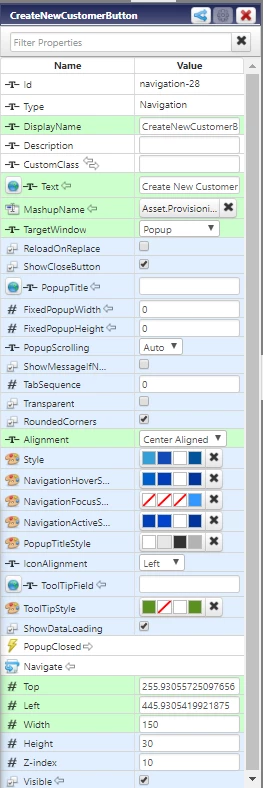

Is the "Disabled" property of the Button widget not available anymore?  I see it in Figure (b) in the following post, but I cannot find it in my Button properties
https://community.ptc.com/t5/ThingWorx-Developers/how-to-disable-a-Button/td-p/526174
I am running Thingworx 8.3.2-b535
I know it can be made visible/invisible, but I prefer to make it disabled/enabled.

@Willie : i believe the things here are mistaken.
the screenshot you attached is actually of Navigation Widget while the figure b in other post is actually a button widget.
In button widget we do have Disabled property , i verified that on 8.3.3 version
but on Navigation widget we only have Visible property - not disabled property
Kindly verify in that respect
Willie16-PearlAuthor
@rosharma Thank you for pointing that out.  I forgot I was using the navigation widget.  Too bad the Disabled property isn't available in the navigation widget.
