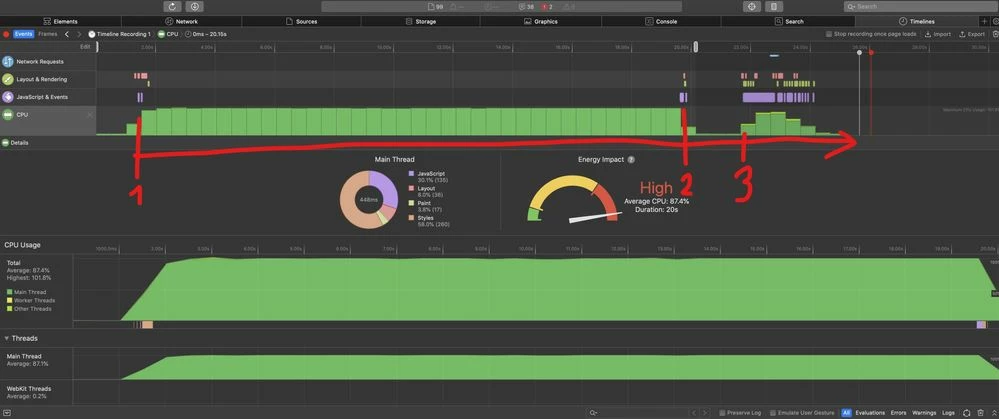

After comparing the performance of displaying a modal popup on a windows device and an iOS device we came to the conclusion that displaying the modal popup on iOS devices leads to performance and stability issues.
Comparison test: displaying an empty modal popup on iOS and Windows Chrome
on iOS it took approx. 20 sec for the user interface to be responsible again (after the input it often crashed, and the page had to be refreshed)
on Windows the modal page is loaded immediately
10 replies
October 22, 2020
After our initial bughunting with @gbirnzain yesterday I investigated a bit further today and the problem seems to not only occur on new versions of iPadOS but also macOS. I tested in Safari on iPadOS 13.7 & 14.2 as well as on macOS Catalina and BigSur, and both on macOS BigSur as well as iPadOS 14.2 the same behavior can be observed.
Below is a screenshot of the tracing from the iPad:
1) tapped the popup-close button 2) iPad reacted to touch again 3) normal input possible again1) tapped the popup-close button 2) iPad reacted to touch again 3) normal input possible again
1) I close the popup here, which freezes the browser for almost 20 seconds
2) popup is now closed, interactions possible again
3) another, random interaction with the page to verfiy it's working as before
Other finds that may be interesting:
  • the Webkit thread does not seem to be doing any work during the freeze, only the main thread is running at 100%
  • behavior did not change noticeably when closing an empty widget vs. one with content on it
