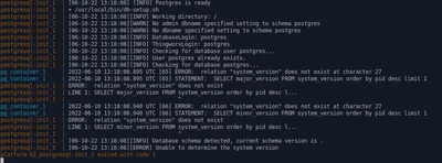

I have built the different doocker image.
When i try to run my docker-compose-postgresql.yml
I have an issue stating:
postgresql-init_1 | psql: error: connection to server at "localhost" (127.0.0.1), port 5432 failed: Connection refused
postgresql-init_1 | Is the server running on that host and accepting TCP/IP connections?
postgresql-init_1 | connection to server at "localhost" (::1), port 5432 failed: Cannot assign requested address
postgresql-init_1 | [06-09-22 13:03:33] [INFO] Postgres is unavailable - Waiting...
My PostgreSQL server is running and i can even connec to It using pgAdmin4 on those port.
Does anyone have a clue?

This does not work for me.
I tested every solution, even the `host    all    all    all    md5'
I think there could be a problem in my docker-compose-postgresql.yml
Here is my pgadmin4 page and the docker-compose file (I've erased the password for this picture but they were written)
Do you have any idea?

I managed to fix the issue by starting my postgresql image inside the docker-compose
pg_container:
 image: postgres:13.0
 environment:
 POSTGRES_USER: postgres
 POSTGRES_PASSWORD: postgres
 POSTGRES_DB: postgres
 ports:
 - "5432:5432"
However, now that I can connect, I get this issue:
postgresql-init_1 | [06-10-22 13:18:08] [INFO] Postgres is ready
postgresql-init_1 | + /usr/local/bin/db-setup.sh
postgresql-init_1 | [06-10-22 13:18:08][INFO] Working directory: /
postgresql-init_1 | [06-10-22 13:18:08][WARN] No admin dbname specified setting to schema postgres
postgresql-init_1 | [06-10-22 13:18:08][WARN] No dbname specified setting to schema postgres
postgresql-init_1 | [06-10-22 13:18:08][INFO] DatabaseLogin: postgres
postgresql-init_1 | [06-10-22 13:18:08][INFO] ThingworxLogin: postgres
postgresql-init_1 | [06-10-22 13:18:08][INFO] Checking for database user postgres...
postgresql-init_1 | [06-10-22 13:18:08][INFO] User postgres already exists.
postgresql-init_1 | [06-10-22 13:18:08][INFO] Checking for database postgres...
pg_container_1 | 2022-06-10 13:18:08.895 UTC [65] ERROR: relation "system_version" does not exist at character 27
pg_container_1 | 2022-06-10 13:18:08.895 UTC [65] STATEMENT: SELECT major_version FROM system_version order by pid desc limit 1
postgresql-init_1 | ERROR: relation "system_version" does not exist
postgresql-init_1 | LINE 1: SELECT major_version FROM system_version order by pid desc l...
postgresql-init_1 | ^
pg_container_1 | 2022-06-10 13:18:08.940 UTC [66] ERROR: relation "system_version" does not exist at character 27
pg_container_1 | 2022-06-10 13:18:08.940 UTC [66] STATEMENT: SELECT minor_version FROM system_version order by pid desc limit 1
postgresql-init_1 | LINE 1: SELECT minor_version FROM system_version order by pid desc l...
postgresql-init_1 | [06-10-22 13:18:08][INFO] Database schema detected, current schema version is .
postgresql-init_1 | [06-10-22 13:18:08][ERROR] Unable to determine the system version
Does anyone have an idea on how to solve it?
