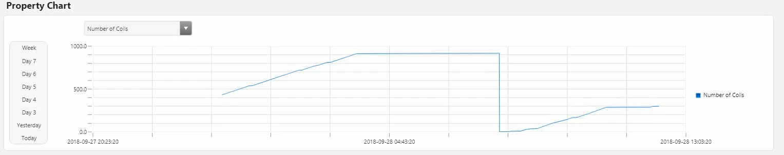

Hi Developers,
I have developed a mashup which has a time series chart showing data (image attached). The requirement is to get this chart/mashup in a pdf file. Is there any default widgets to achieve this functionality.
